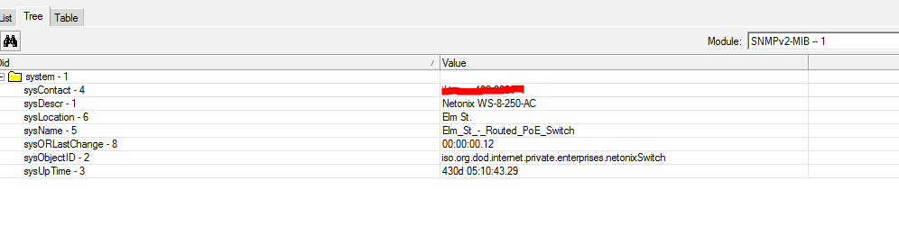

sbyrd - Experienced Member
- Posts: 236
- Has thanked: 16 times
- Been thanked: 26 times
Re: v1.3.9 FINAL bug reports and comments
sirhc wrote:sbyrd wrote:I will give it a try off hours later tonight. So far I have 3 WS-Minis on 1.39 or 1.39rc15 and they all report uptimes of 429 days. I have another WS-MIni on 1.33 with a SNMP uptime of 117 days and GUI uptime of 118 days. My WS-12s and WS-8 (running much older FW) are reporting uptimes correctly.
I will work on upgrading all my switches to 1.39 (including my WS-12s and WS-8) and report back.
If it matters I am using The Dude for SNMP and pulled these values using SNMP walk.
OH, My bad I did not read your post correctly, I thought you were referring to the UI report of uptime.
Yes upgrade them to v1.3.9 and report back as there were MAJOR changes to SNMP in v1.3.9
There may be a bug on the SNMP reported up time so yes please upgrade and review the release notes.
Also note that you now must use our new MIB file located HERE
I upgraded a WS-8-AC from 1.2.0 to 1.3.9 and now it is reporting the uptime in SNMP as 430days. On 1.2.0 the uptime was reported correctly. So as of now i have 4 switches on 1.3.9 that all have uptimes of 400+ days.
Eric confirmed SNMP reported uptime is a bug. We will release a fix in v1.4.0rc2 soon
v1.4.0rc2 is released which fixes SNMP reported up time.
No core changes so if the up-time is what you want then it is a safe upgrade to get it.
Was that fast enough on the fix?
