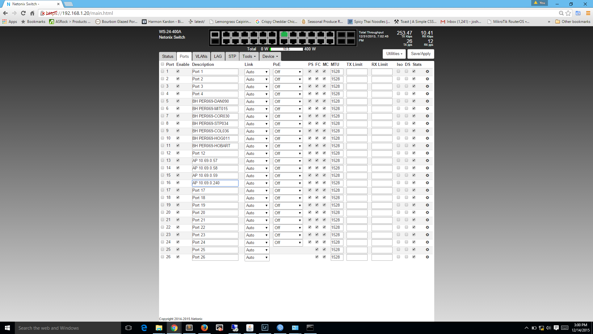

I'm still having this problem, and now it's happening even when I try to enable PoE on one port (not several).
I have tried two WS-24-400A's, 3 laptops (Windows 10 and Windows 7), and Firefox and Chrome. I have confirmed that this only affects management access, the switch still forwards traffic.
In both cases, the switches are running 1.3.8 final.
Any ideas?

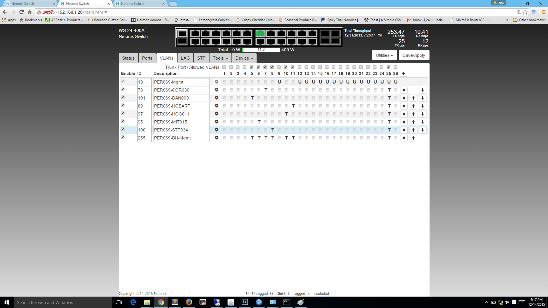

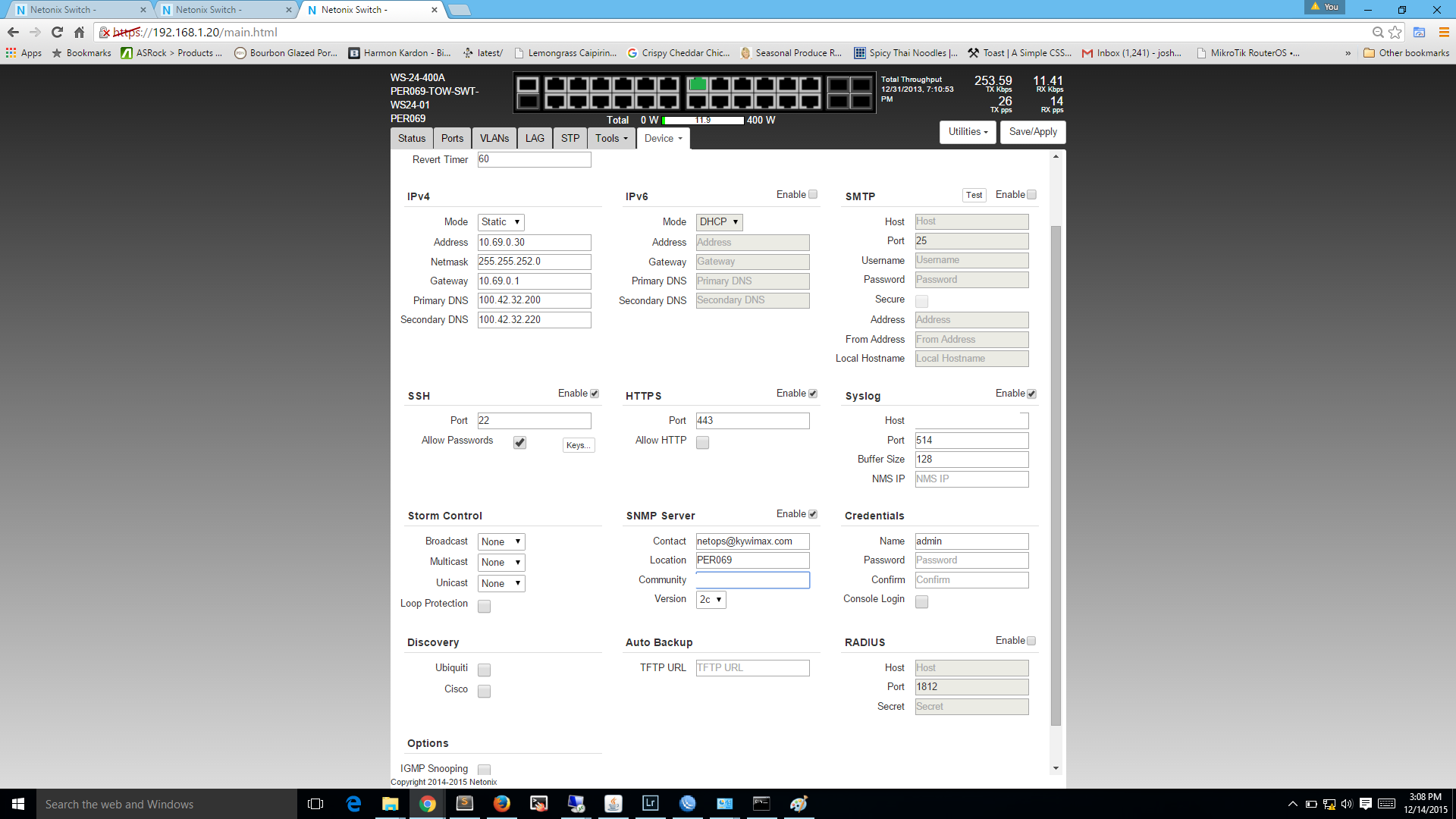

Could you please default a unit, then go through the process of setting up the config you want but do not save and apply and post up screen grabs of your Tabs.
Please post "any" Tab or drop down that is getting "any" changes.
jbaird
Posts: 43
Joined: Fri Oct 09, 2015 3:47 pm
Location: Danville, KY
Re: Switch crashing/locking up with editing port description
Mon Dec 14, 2015 4:50 pm
Here are the screenshots.
I applied the configuration on another WS-24-400A, and the switch seems to be working fine now. Then, I exported the config, factory reset the other WS-24-400A, and then loaded this "working" config. The switch is doing the exact same thing - management access dies when applying various changes, and other oddities such as the interface reporting power is enabled on a port, but not actually powering the port.
