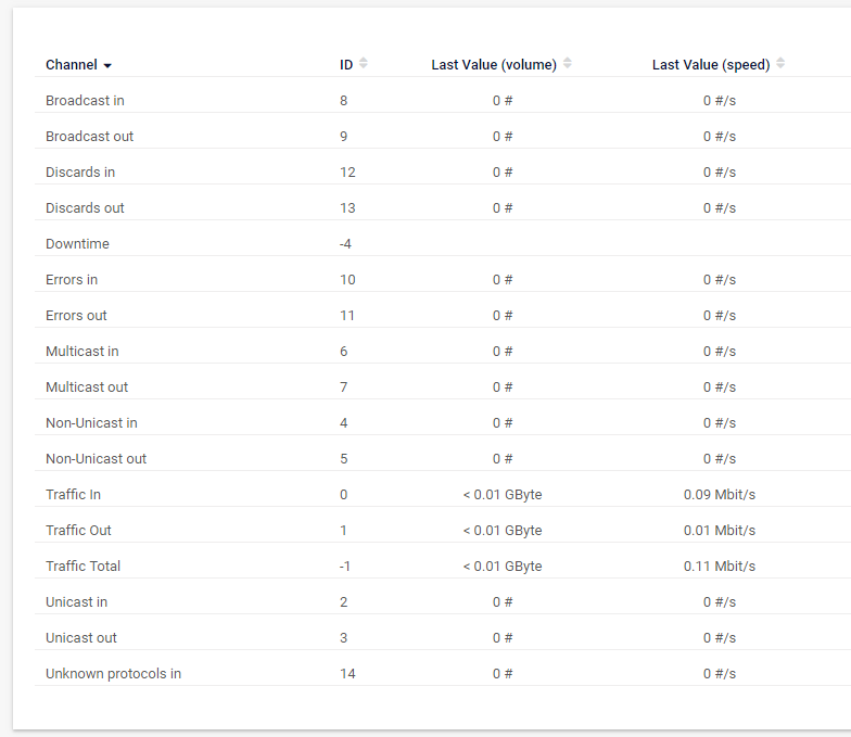

I have PRTG configured to monitor a test swtich, WS-6-POE. FW 1.5.3
Imported the MIB, added the sensors, things worked out. While looking at the port traffic sensors, I see that Traffic In, Traffic Out, and Traffic Total give me reasonable numbers, but all the packet stats remain at zero, both in table form and historical graphs. While this link had little traffic this morning, I would still expect to see some numbers. Perhaps these are not populated in the switch, or PRTG is not reading them correctly. Anyone has gotten these to work?
- Posts: 1077
- Been thanked: 208 times
Re: Setting up PRTG to use SNMP with Netonix
Just to cross-reference the numbers, you can check the total throughput on the switch in the UI at the top right corner. You can also monitor the live stat's of each port by clicking on the gear at the right of each port in the Status tab.
