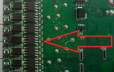

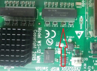

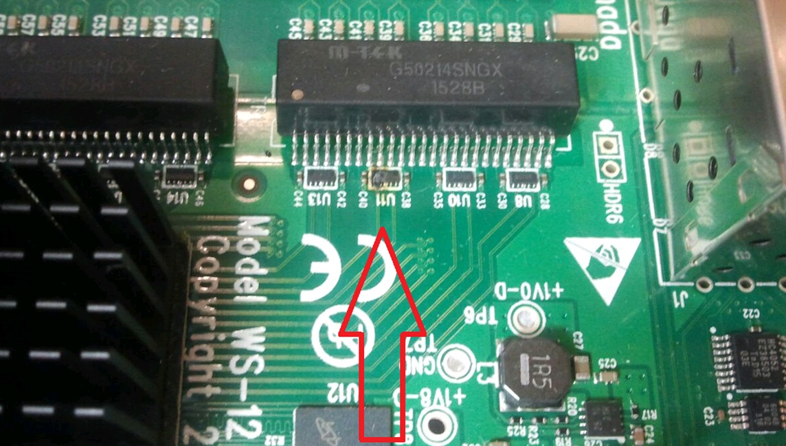

The pictures below are from 3 of the damaged boards I charged to repair or replace the boards today:
This is a blown current sensor "probably" from grounding issues, either inadequate grounding and or tower grounding system is not bonded to service ground properly.
The next 2 pictures are from either poor grounding and or just bad luck but damage is the ESD protection circuit that is on the inside of the Ethernet Transformer which means it "probably" was a sudden high voltage surge as it had to jump the Magnetic coupling of the Ethernet Transformer and be high enough voltage to pop the chip like that. Now it is possible to be a low steady excessive current and slowly heat that chip up until it splats but more likely it was sudden but my crystal ball is no better then yours but I do know this is NOT a failure due to defect or simple parts failure but rather the result of environmental circumstances.

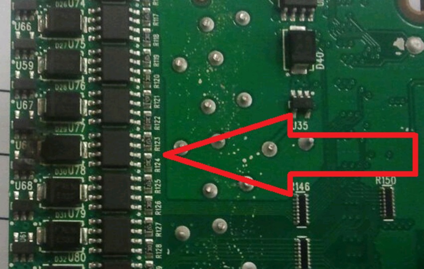

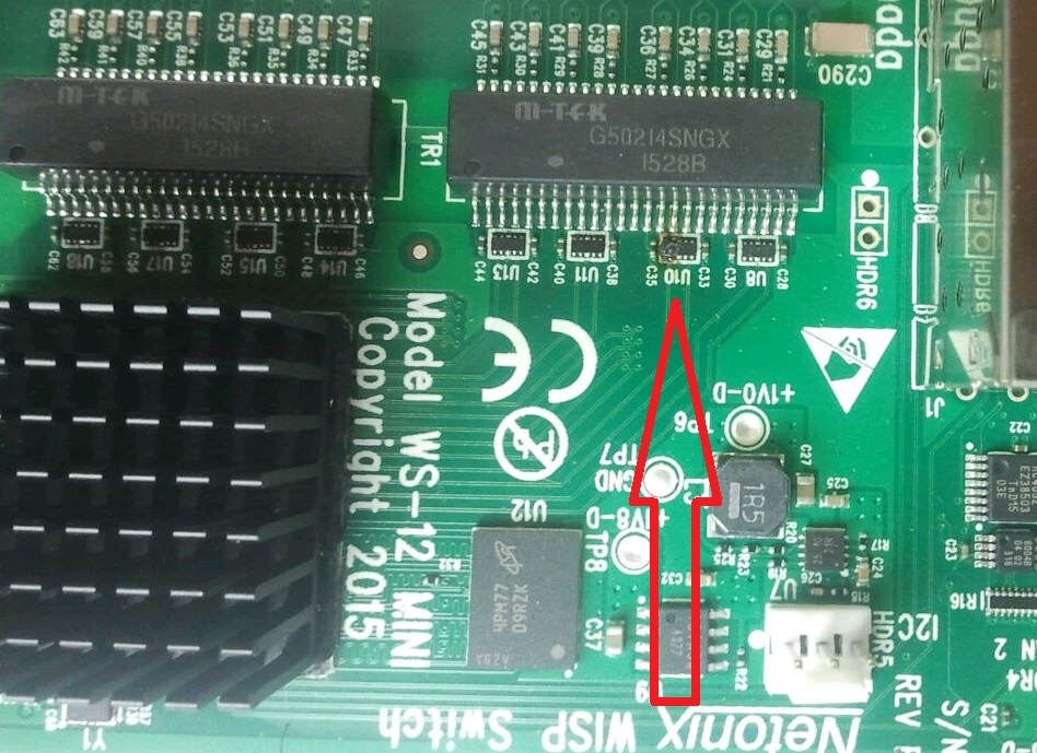

Current sensors get damaged from surges or ground potential differences. To blow a current sensor you need to have voltage > 80V DC as that is the upper limit rating of the current sensor or a ground potential difference which forces excessive "current" through the port. Surges can come from Static or ESD discharges.
If you manually turn POE back on look and see if any watts are being reported as being used, my guess is it shoes 0 watts.
Move the cable to another port and see if the problem goes away.
We could think about taking this feature out, I will discuss with Eric and Dave.
viewtopic.php?f=30&t=1816
viewtopic.php?f=30&t=188

The only damage I can think of from your examples would be ESD. Although, I just ran it in my office for a few different weeks. burned it in. Then did the one install. This all occurred during its first install and as soon as I hooked it up. It occurred on all 6 ports that I tried. I captured a little longer log....
Do you still think its just using so "little energy" that it thinks it should shut the POE off? If so, should I just wait for a firmware update?
Do you have a way for me to quickly test to see if I have a blown board?

ESD or Static discharge is a common damage we see but most common is Ground Potential Shift from no or improper bonding between the tower and service ground and no dedicated bond wire from cabinet to radios. Also we see a lot of damage from people getting power from a distance and using the Earth Ground from the Electric service from a Distance.
If using AC power from a distance do what is described in this post:
Sure, here is how you test a switch, take it to your bench:
1) Factory default it and log into it with your laptop.
2) Verify each port gets a 1G connection to your laptop or another 1G device that is not POE such as a switch or another laptop. Any port that does not get 1G do a cable diagnostic with nothing plugged in to the port. You should get OPEN, OPEN, OPEN, OPEN for all 4 pairs. Anything else and you have a damaged Ethernet Transformer. Or if the test hangs you also have a damaged transformer and possibly damaged PHY.
3) Use any airMAX radio known good such as a NanoStation and plug into each port and turn 24V POE ON. Now observe the Status Tab and you should get 1-6 watts, if you get 0 or HIGH watts you have damaged current sensors.
4) Verify all sensors on Device/Status Tab, if they are wrong chances are I2C bus is damaged somewhere probably a current sensor.
viewtopic.php?f=30&t=1429
