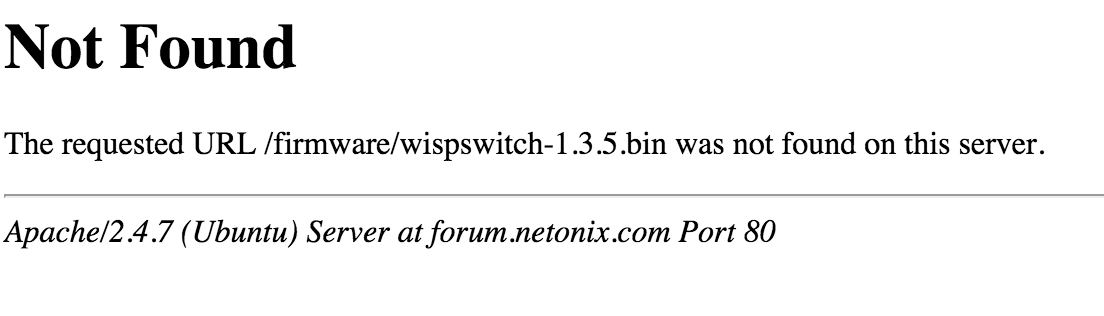

Did you guys pull the update? Went to download 1.3.5 this morning and it says file not found.

Dawizman wrote:Did you guys pull the update? Went to download 1.3.5 this morning and it says file not found.
Same issue here.

Been thanked: 1362 times
Re: v1.3.5 FINAL bug reports and comments
Wed Oct 28, 2015 10:16 am
Yes, I just pulled it so we can post a FIX for the reported issues later today
