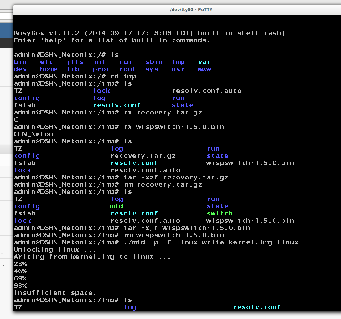

I haven't been able to replicate this issue so far on the WS-8-150-AC which might mean it is a hardware issue. But before that could you send a screenshot of the commands you're running?
ptera
Posts: 11
Joined: Thu Jan 12, 2017 1:49 pm
Re: FIRMWARE RECOVERY VIA CONSOLE PORT
Mon Aug 13, 2018 10:15 am
Here it is.

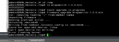

Mon Aug 13, 2018 3:37 pm
OK, everything looks right (except that it's not working of course).
Try this:
1) cd /tmp
2) rx wispswitch-1.5.0.bin
3) touch upgrade_in_progress
4) firmware_upgrade wispswitch-1.5.0.bin
Let me know what this does. Depending on what the original issue was, this has worked for me under various circumstance's.
ptera
Posts: 11
Mon Aug 13, 2018 6:24 pm
No fun
Stephen
Posts: 1080
Has thanked: 105 times
Been thanked: 210 times
Tue Aug 14, 2018 8:41 am
By any chance did you try this after rebooting? (As in complete power down, and power up)
Btw, when and how did this all start occuring?
