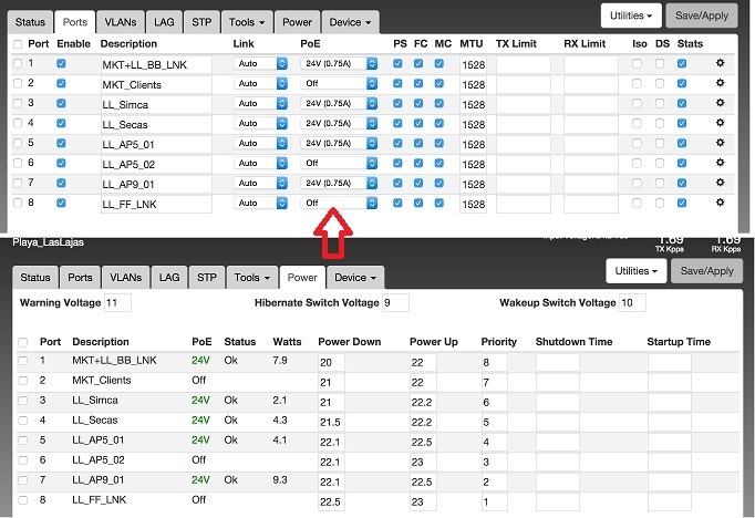

tried this again with POE load (not radio, just a resistive test load on port), works fine every-time for me. But I can see that your port does not have the GUI port tree having the port in question turned on....not sure what to try because it works for me....hmmmm, mind you I am using a 12 port dc-dc unit for testing, but should be no differences from a code point of view.
Can you send me screen snapshot of your ports page?

sorry, didn't notice you already posted Ports page..
Re: Power off issue with DC Switch
What I see on the Ports Tab is that POE is turned OFF.
When the Power Tab turns a port POE OFF because input voltage drops below the specified voltage on the Power Tab (23.5) it does not change the POE status on the Port Tab.
Meaning as far as the switch is concerned Port 8 is configured for 24V but the Power Tab Temporarily Disables the POE power due to insufficient input voltage.
But with that being said your screenshot shows POE turned OFF for Port 8 on the Ports Tab.
The only software function that will turn the POE OFF on the Ports Tab is POE Smart. Is there any mentioning to POE Smart in your switch log?
please post up your properly formatted Switch log please.
Humm,
Well this morning it seems to have works as designed...
Will check for the next couple of days...
Disabling PoE power on port 8 due to Input Voltage (23.4 Vdc) less than user specified Power Down voltage (23.5) - from LL_Netonix (x.x.x.x) .
Enabling PoE power on port 8 due to Input Voltage (23.7 Vdc) greater than user specified Power Up voltage (23.6) - from LL_Netonix (x.x.x.x)
This time the power on the port actually did come up...
I will report what happens tomorrow morning to see if we can close this issue.
/d
/d
Folks,
Second day, this worked as designed, please consider this resolved
/d
/d
