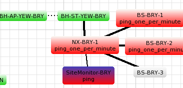

Have a problem upgrading WS-8-250-DC from 1.3.1 to 1.3.3. (updated I though it was 1.3.2, actually we were running 1.3.1)
Switch is not coming back online after the following prompt "The interface will reload when the reboot is complete"
Can't ping it.
This switch is remotely backhauled by a NanoBeam N400 and the switch is powering the remote NanoBeam, and I can get onto this, but I can't ping the switch or contact it via SSH from the remote NanoBeam just to rule out some craziness.
Switch was recently installed on Tuesday. Worked fine until this upgrade.
port 1: 24v Nanobeam N400 backhaul in
port 2: 24v RocketM5
port 3: 24v RocketM5
port 8: site monitor
Management VLAN is: 115 and tagged on port 1 (the uplink).
I previously upgraded a 12 port AC and a 24 port A version without a hitch.
Any ideas?
Truck roll needed I think to get this back online.
Fortunately this is a new site - only 2 customers offline.
Re: v1.3.3 FINAL bug reports and comments
Thu Oct 01, 2015 1:26 pm
So the tower is up and all the radios are up you just can not access the switch anymore?
bmv
Posts: 30
Joined: Sun Aug 23, 2015 4:07 am
Location: Dorset/Wiltshire, UK
Has thanked: 5 times
Been thanked: 12 times
Thu Oct 01, 2015 1:34 pm
sirhc wrote:So the tower is up and all the radios are up you just can not access the switch anymore?
As this is a remote switch, we can see the remote backhaul dish up. Nothing else is showing up.
Potentially the base stations are powered, but no comms to the switch or through it via the upstream link.
- Dotted line is a 2km wireless link.
- BS-xxx-x are our Rocket M5 base stations
- BH-AP is the AP end of the backhaul link.
- BH-ST is the Station end of the backhaul link.
- NX is the WS-8-250-DC
- The greyed out base station is not yet commissioned.
BRY network down after netonix upgrade.PNG (10.65 KiB) Viewed 27243 times
We have tested to see if the management IP address has jumped onto VLAN1, or the native VLAN rather than tagged. No luck.
We have tested to see if the management IP have jumped back to 192.168.1.20 default. No luck.
I guess we need a site visit?
