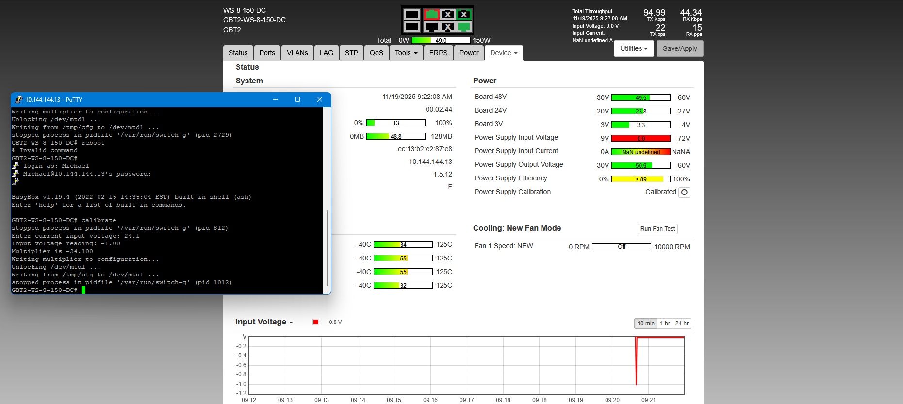

cannot calibrate! [img]Y:\Dark%20Alley\2025\Red%20Coyote%20LLC\Wisp\Hardware\Power%20&%20Solar\NetoniX\ws-8-150-dc.png[/img]How do I fix this? Updated to 1.5.26 - same result
Re: v1.5.26 Bug Reports and Comments
Wed Nov 19, 2025 4:07 pm
The unit is damaged. RMA it at rma.netonix.com
