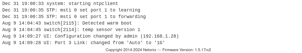

Re: v1.5.17rcX Bug Reports and Comments
On initial boot up, it takes a bit for system time modification from ntp to be reflected in the logs. If you make a modification going forward. The logs should update to the correct time.
Here's a screenshot to show what I mean, I modified Port 3 just to show it updating the log with the correct time after ntp is set.
Stephen wrote:On initial boot up, it takes a bit for system time modification from ntp to be reflected in the logs. If you make a modification going forward. The logs should update to the correct time.
Yes, later when I updated a downstream switch, the port bounce in the log showed the correct date/time. On the older firmware, the end of the log file always showed the correct date/time. It was just an observation.
