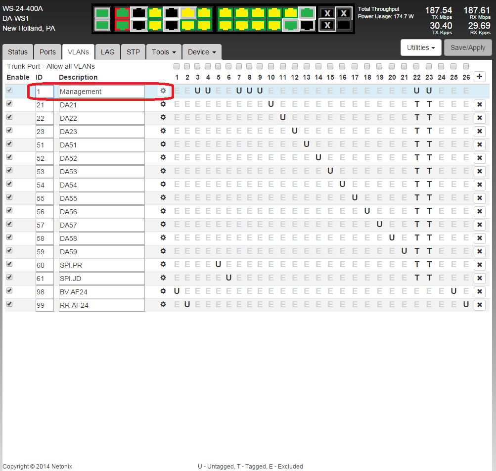

QuadeHale wrote:I'm not asking for a gateway, so much as to pick a management VLAN on the device config. the ToughSwitch did it (a radio button beside the VLAN) that let you pick which VLAN the management sat on. That's what I'm after. I don't need multiple default gateways, I need the management of the switch to be on a VLAN other than 1/UT.
And you can with our switch as well?
The "Management or Default" VLAN which by default has an ID of "1" can be changed to whatever VLAN ID value you want between 1 and 4096.
You can also rename it as well from "Management or Default" to whatever you desire?
The Switch' s MAIN IP address resides on the "Default or Management" VLAN, if you renumber this VLAN ID the MAIN IP goes with it which is why the little gear to the right of the description on this VLAN is greyed out and you can NOT disable it.
CLICK ON IMAGE BELOW TO SEE FULL SIZE

Re: Proper VLAN Management Config
When did that become available? When I last checked I couldn't change that VLAN.
sirhc wrote:QuadeHale wrote:I'm not asking for a gateway, so much as to pick a management VLAN on the device config. the ToughSwitch did it (a radio button beside the VLAN) that let you pick which VLAN the management sat on. That's what I'm after. I don't need multiple default gateways, I need the management of the switch to be on a VLAN other than 1/UT.
