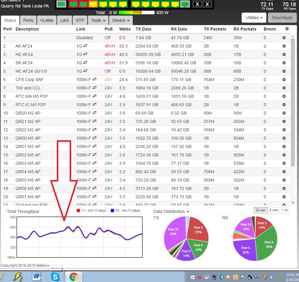

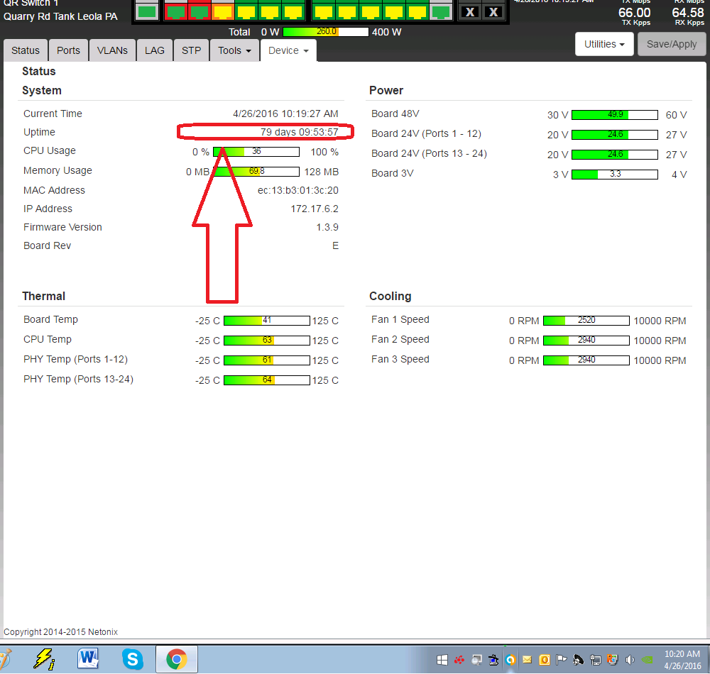

Tue Apr 26, 2016 10:20 am
Well all of the switches use the same design, same switch core, and same firmware.
My switches are moving upwards of 1G of traffic most of the time so I do not think it has anything to do with that.
