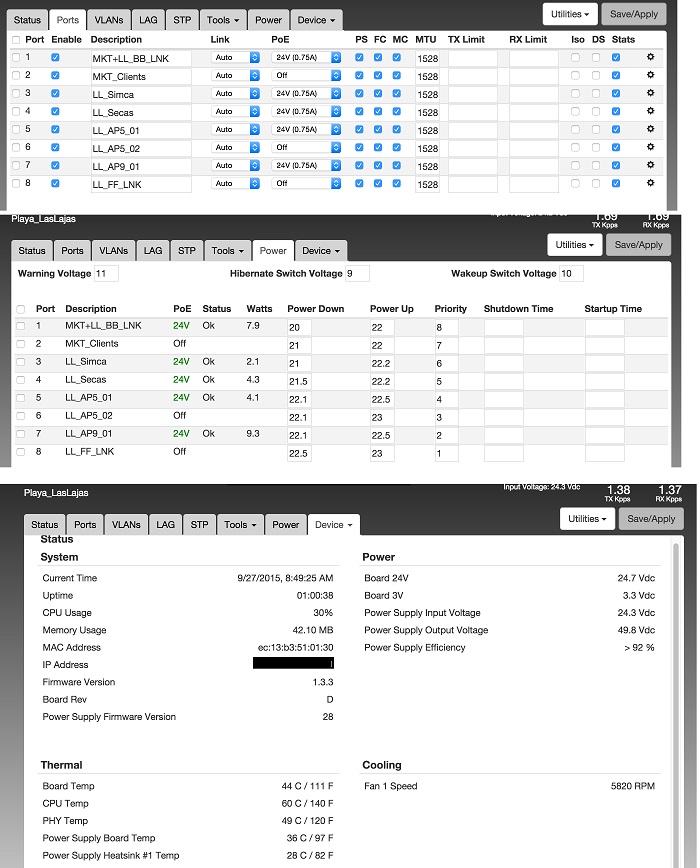

Ports 5,6,7,8 disabled due to low voltage
Voltage now at 22.9, set to come up at 22.5, nothing happened
I realize I am running one version lower that current but release notes indicated no changes to this feature...
Please upgrade to v1.3.3, there were changes in the the firmware, we need you to be on the latest version of the firmware.
Please post a screen grab of the Power Tab, Ports Tab, and Device Config Tab (After firmware upgrade)
If you upgrade the firmware and post the requested Tabs we will simulate this in our LAB and see whats going on.

Re: Power off issue with DC Switch
OK
I guess it is best to wait until tomorrow morning and see if the issue remains. I have now upgraded the switch.

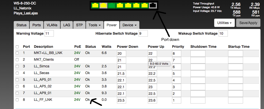

The issue remains with latest firmware.
Set off voltage to 23.5
Oct 3 05:03:04 switch[1366]: Disabling PoE power on port 8 due to Input Voltage (23.4 Vdc) less than user specified Power Down voltage (23.5)
Oct 3 07:15:03 switch[1366]: Enabling PoE power on port 8 due to Input Voltage (23.7 Vdc) greater than user specified Power Up voltage (23.6)
Power tab shows port as OK but no power to port, but port did not power up, see screen shot
Fix was: after voltage was above threshold, disable POE to port, re-enable POE
/d
capandave
Sorry, I thought the GUI indicator was saying no POE power, not that the indicator was ok, but no actual power to port.
I will double check in lab.
Thanks for your help.
