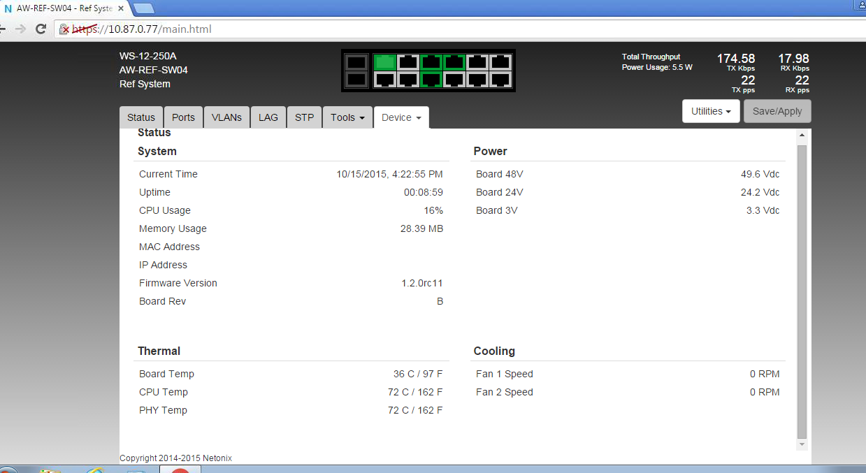

Just upgraded a brand new switch from version 1.2.x to 1.3.3. If you see the attached screenshots, both shows the same CPU and PHY temperature.
Is is correct that the CPU temperature is 72 degree Celcius ?.
After Upgrade
Before Upgrade

Re: [URGENT] High CPU Temperature
Fri Oct 16, 2015 9:57 am
yes, 72 degrees is nice & cool for the CPU.
Fri Oct 16, 2015 10:37 am
My fans turn off at 67C and on at 74C.
Sat Oct 17, 2015 12:13 pm
The CPU and PHY are rated to run at 125C all day long if need be.
