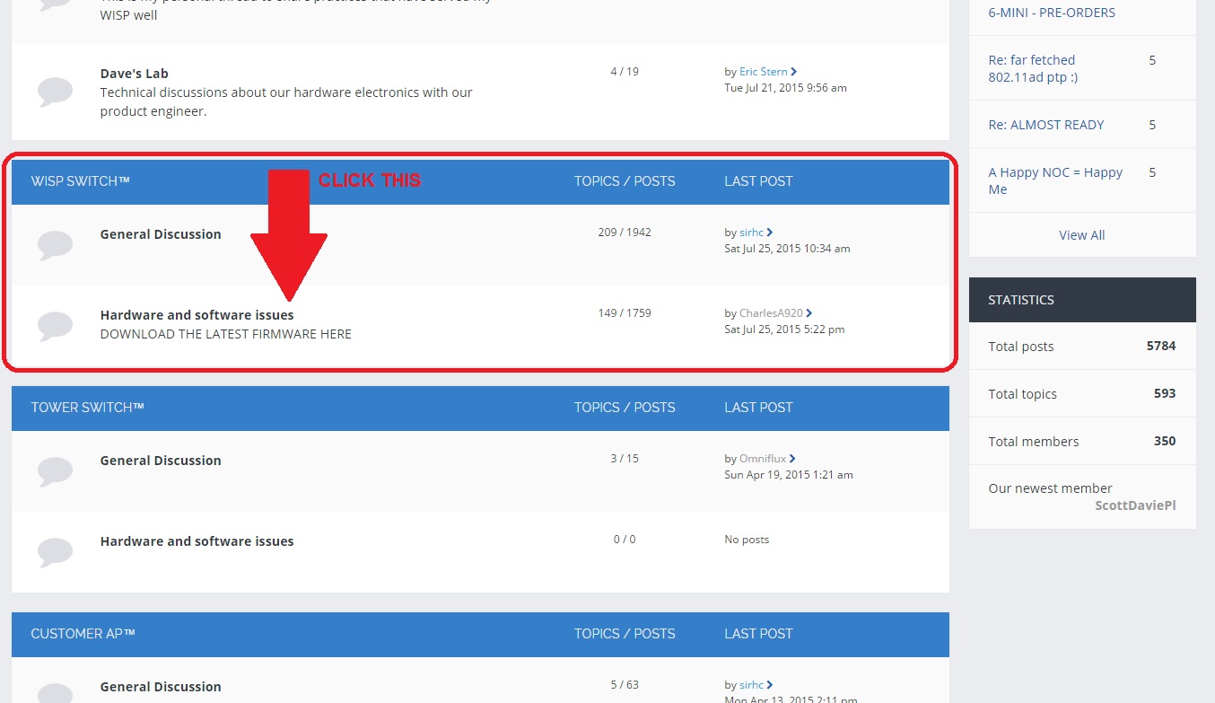

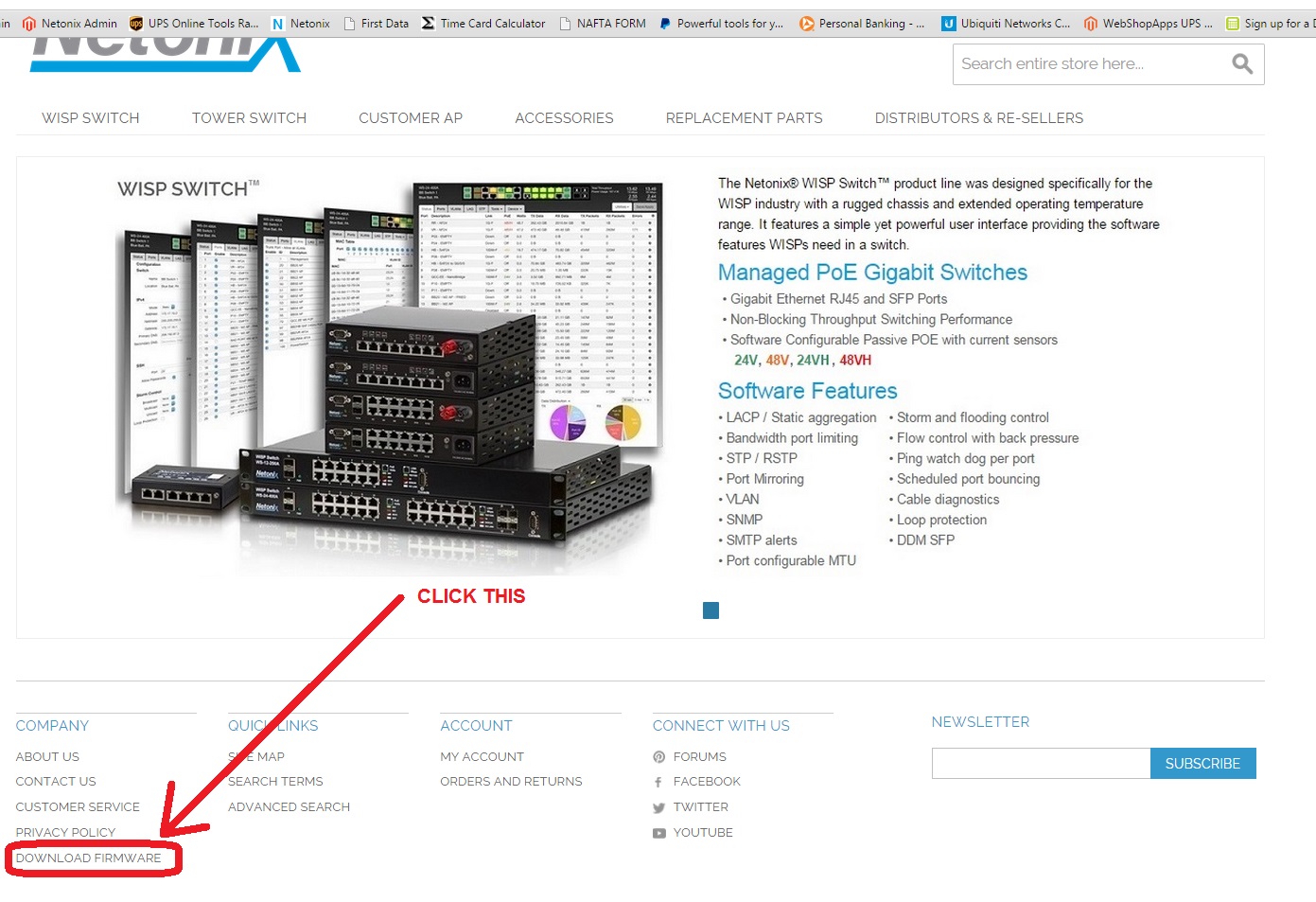

Well you can find the firmware pretty easy, I think anyway?
From our MAIN web page at the bottom there is a link that takes you directly to the firmware download thread.
Or once you are at our forums you do the following.

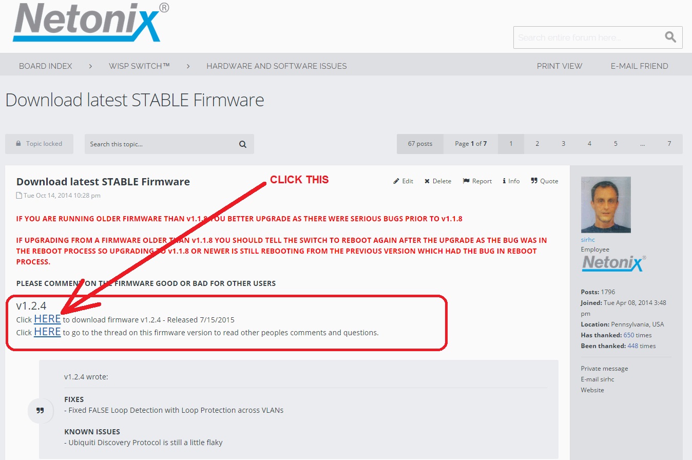

V1.2.4 is the latest stable. YOu can find it and all prvious versions in the following thread.
viewtopic.php?f=17&t=240
viewtopic.php?f=17&t=845
