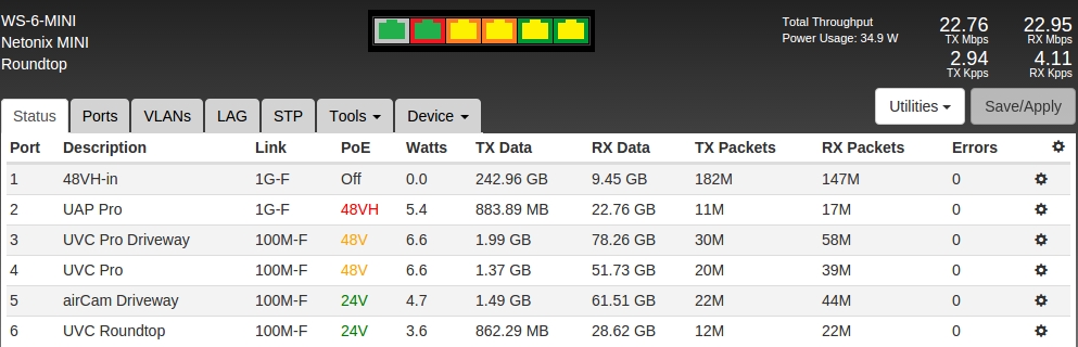

They will not be the same. Their is a voltage drop across the bridge rectifier diodes in the 6 port that software is currently not considering (I never told Eric about it).
Plus we have a power drop across the network cable.
Will discuss with Eric for a fix in next release.

lligetfa wrote:Chris, take a look at the numbers on the screenshot I posted a few days ago. Keep in mind it was in daylight so no IR means the UVC draws a little less.
viewtopic.php?f=14&t=594&p=4317#p4317
Here is a daytime screenshot for an apples-to-apples comparison. The only change is firmware version. I understand that what I have is a prototype. I would be more than willing to test the revised production model. Pirate4
