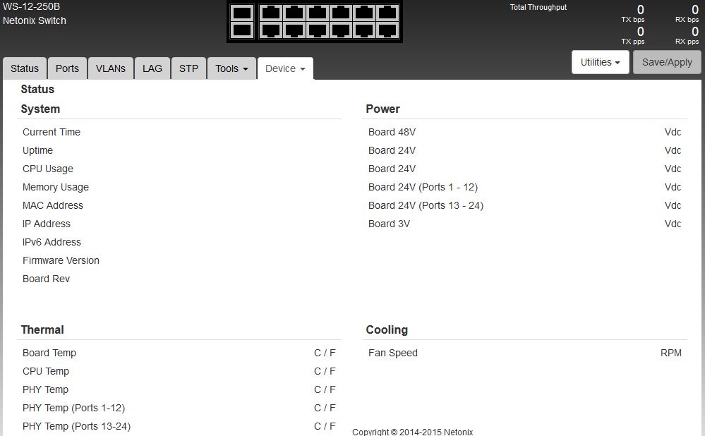

I have the same issue with the GUI after upgrading from 1.1.1 to 1.1.3, fortunately it is still passing traffic. I have tried Internet Explorer and Firefox.

I am pretty sure a reboot would fix your issue which you could do by SSH into it and issue the command "reload cold", but the safest way of course would be to be on site just in case.
But if you're going to be around later today and have Teamviewer loaded on your laptop Eric could take a look at your switch for you and probably fix it up via SSH.

FYI for those encountering the GUI issue: I reflashed the unit with v1.1.4. Again, the browser got hung up at the end, BUT, the GUI now appears and works normally in Chrome and IE11 after getting through the security warnings about certificate errors and encryption (supporting as high as TLS1.0 but not 1.1 or 1.2). It still does not work with any current browser with a Mozilla engine, e.g., Firefox, Pale Moon, SeaMonkey. With Mozilla, the information is blank and if an action is attempted via a dropdown menu a pink banner will drop down saying a firmware update is still in progress, even though it is not.
