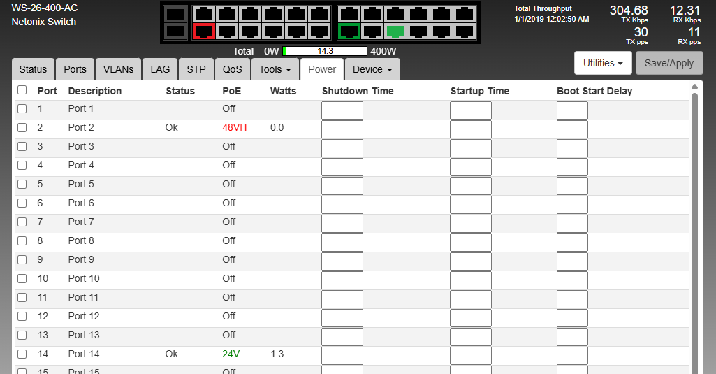

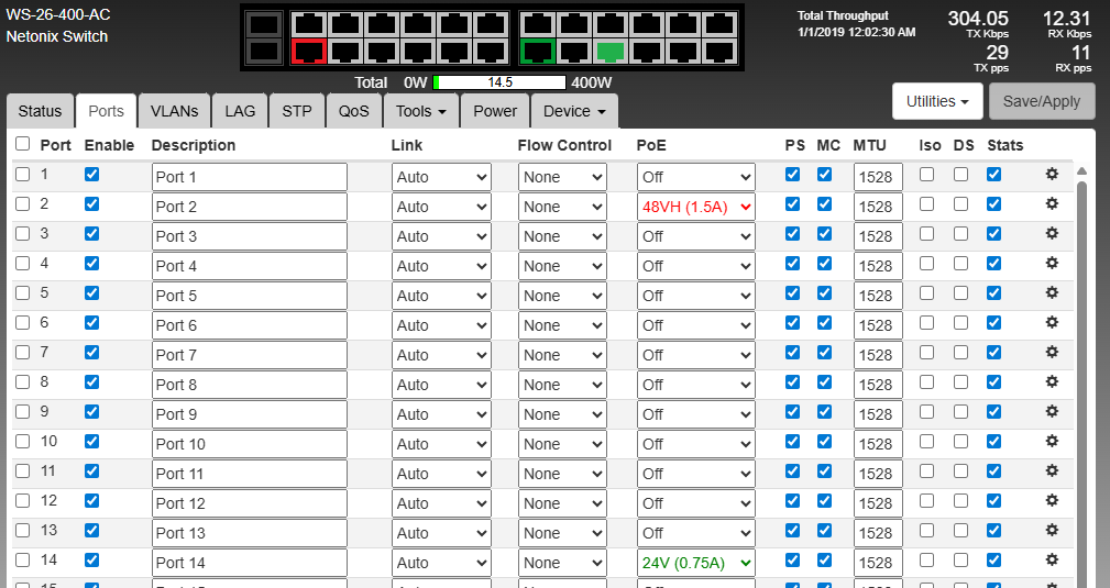

Note on the screenshots below. Port 14 shows a 1.3w power draw. That's with a Mikrotik Cube plugged in but it does not power up. If I unplug it, the port shows a 0w reading.

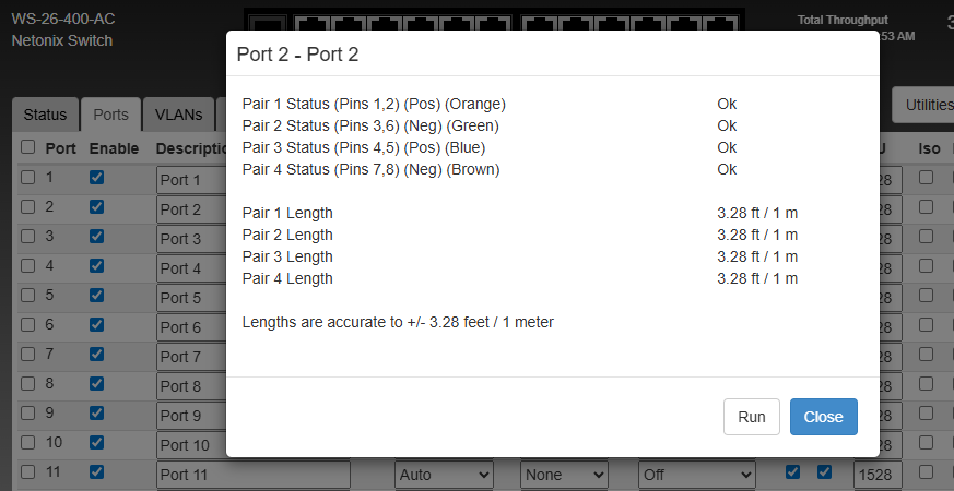

If I disable POE on port 2 and run cable Diagnostics to my Laptop it passes.

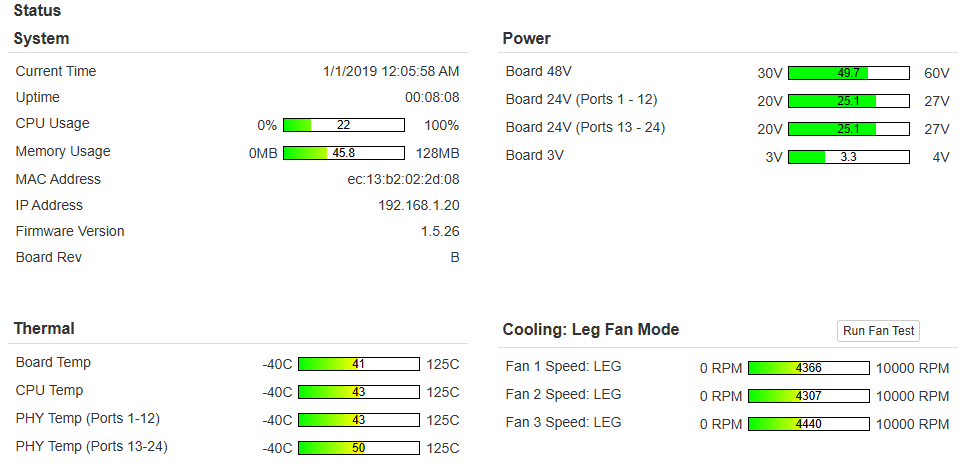

Jan 1 00:00:56 UI[1415]: PORT 2 PoE: Off => 48VH
Jan 1 00:00:57 switch[1459]: PoE enabled on port 2, PoE Smart is starting cable check
Jan 1 00:01:02 switch[1459]: Port 2 cable check results: Open, Open, Open, Open
Jan 1 00:01:02 switch[1459]: Port 2 passed PoE Smart cable check, turning on power
Jan 1 00:01:07 UI[1415]: PORT 14 PoE: Off => 24V
Jan 1 00:01:09 switch[1459]: PoE enabled on port 14, PoE Smart is starting cable check
Jan 1 00:01:14 switch[1459]: Port 14 cable check results: Open, Open, Open, Open
Jan 1 00:01:14 switch[1459]: Port 14 passed PoE Smart cable check, turning on power
