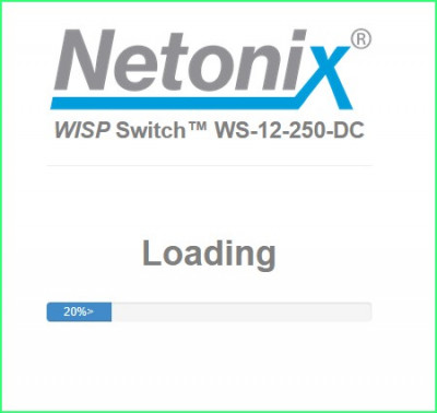

Hello everyone,
the problem occurred again after sixty days ...
This time I had the opportunity to be in front of the terminal and while I was trying to access the switch web console I saw this progress bar that I had never seen before ...
Is this a normal thing?

Re: Periodic reboot of WS-12-250-DC switches
Well after you logged back in did you check the uptime kn the device status screen to confirm a reboot did indeed occur.
Several causes or guesses as I don't know your setup.
Power dip to the switch which would cause it to reboot.
Other than that disable all services not required such as
SNMP
SMTP
DISCOVER AND DISCOVERY TAB
All located on device config tab.
You have to do some diagnoses as my crystal ball is broken.
Other causes are loops, poling SNMP more then once per minute or god forbid polling with multiple SNMP servers. A DEFINIT NO NO
Using more than one Netonix manager to monitor switch. A DEFINIT NO NO
If switch is accessible from web either valid IP or port mapping through NAT and not using access control list.
So disable all services you can. Make sure not poling more than once per minute from ONE SNMP server. Implement access control list. Verify power. Remember we tell you NOT to power from charging controller but instead hook directly to battery bank with in line fuse. (See othervposts).
Beyond that take screen shots of all tabs not using default values and UPLOAD to post using the upload attachment link below blue preview and submit button DO NOT LINK PICTURES TO OFF SITE LOCATION.
