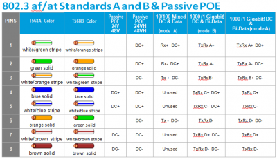

The ePMP 3000 series, including the 3000L, is polarity agnostic and can be powered with either standard PoE (4, 5, 7, 8) or alternative PoE (1, 2, 3, 6). The 3000L, in particular, requires 24V PoE and will not work with 48V. The ePMP 3000 AP (not the 3000L) uses 48V PoE.
Here's a more detailed breakdown:
ePMP 3000L:
Voltage: 24V.
Polarity: Agnostic (works with both standard and alternative PoE configurations).
Standard Pinout: + on 4/5, - on 7/8.
Important: Do not attempt to power with 48V.
ePMP 3000 AP:
Voltage: 48V.
Polarity: Standard pinout is expected.
Important Considerations:
Checking PoE Pinout: When connecting an ePMP 3000L, verify the PoE pinout of your switch and ensure it matches the 3000L's requirements.
Voltage Limits: The 3000L should not be powered by voltages higher than 30V.
Crossover Cables: If necessary, use a 5-pin to 7-pin cross-over cable adapter for compatibility with certain power supplies.
