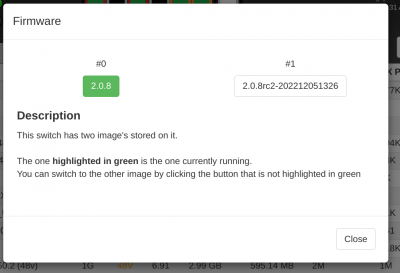

When I upgraded to 2.0.8 from 2.0.8RC2-202212051326, the device did not successfully complete the automatic reboot process after the new firmware was applied. It remained with all ports turned off for 15 minutes, after which I unplugged the power cable and forced another reboot. It appears to be fine after that.
Therefore, for anyone else upgrading, ensure you have someone on-site; don't do this remotely.

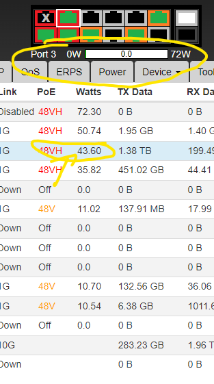

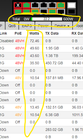

we find a problem in displaying the power supplied on the individual ports and in the total, below are the photos:

Long time user of Netonix WISP switches here, just installed my first WS3-14-600-DC running stable release 2.0.8. My configuration is fairly simple with only four VLANS, no LAGs, and STP is turned off. Connected to CCR2116 router via 10G. No hyphens in the switch name. Overall we love the new hardware so far, but I do have a couple minor issues to report:
1) I observe the same POE power utilization display issue as previously reported here: Netonix Forums • View topic - v2.0.8 Bug Reports and Comments - WS3 Firmware Further to the OP's report, I believe this erroneous data is also causing inaccurate power supply efficiency data to be reported. I see that the release notes were quoted in response to the original issue report, but I don't see any specific correlation with the issues identified in the release notes.
