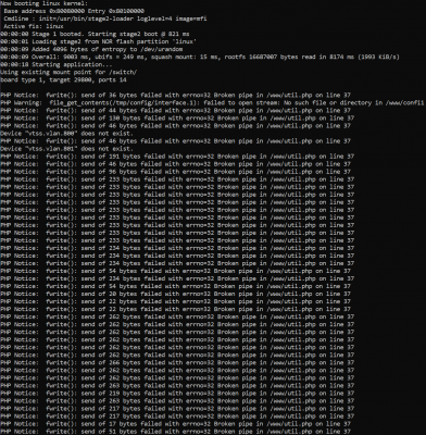

To jog everyone's memory's I've attached an image of what occurs following the roughly 10 minute period that the WS3 units lock up for. This particular image was captured today after a reboot.

Another update:
It appears that the crashing and lockups are due to improper handling of the switch name field. As my previous posts note we have been using a switch name that contains hyphens. If the switch name contains hyphens it is guaranteed to lockup and require a factory default to function again. There also appears to be an issue if LLDP is enabled which can cause the lockup.
So now my question is, did nobody use the same switch name that I had listed in my prior posts when trying to reproduce this bug? I re-checked my original thread troubleshooting the original WS3 I had, and Stephen even acknowledged that this may be the issue that the WS series switches had.
