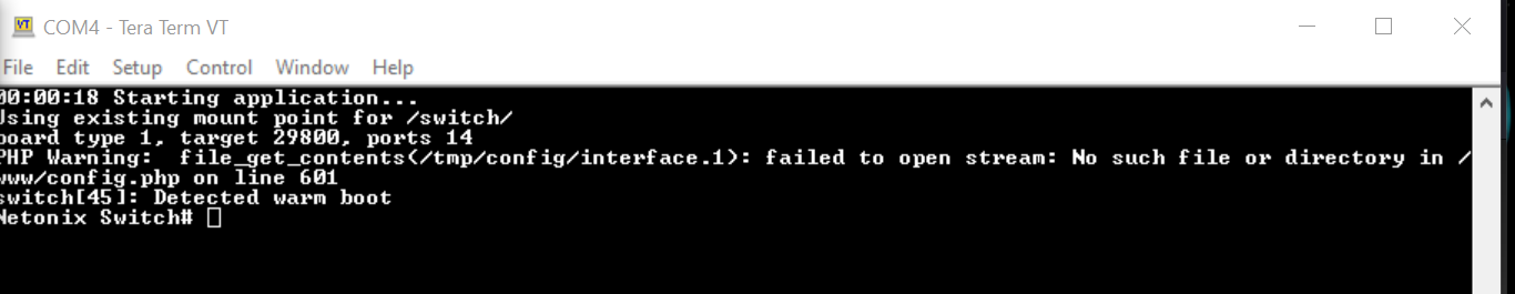

I hate to be the bearer of bad news but some issues that were present in v2.0.6RC4 appear to still be present in this version. I've written up the steps taken leading up the the errors and attached them as a text file. I've also attached the output of the serial console. As well I have attached an output that occurred spontaneously while I was writing this bug report.
As you can see the issues started when I attempted a config restore.

Quick update, since I posted that bug report the switch has rebooted itself again, the following was displayed. Appears to be the same error as earlier bug reports.
WS3-Error-2.txt
(14.07 KiB) Downloaded 1121 times

Updated from RC5 and still seeing all the previous issues I've reported. Basic config changes like setting an IP, changing the device name or updating the Management VLAN seem to break the switch. It requires defaulting to restore access. I also saw the same PHP errors mentioned above while I had a console cable connected.

It's impossible to say without knowing the original fault trigger but the switch does appear to be more stable. Since my last post I have determined that there is still a fault trigger in the configuration options. It appears that changing IPv4 settings in conjunction with any other setting causes a switch lockup accompanied by the same fwrite and PHP errors, as of the moment the only fix is to factory default the switch as after the problem occurs there is no GUI access.
The issue occurs if:
- IPv4 DHCP is enabled alongside another setting change
- IPv4 DCHP is disabled alongside another setting change
- IPv4 static IP is changed alongside another setting change
In all three cases the switch states the configuration changes was successful but the IPv4 address does not change. If the switch is then rebooted it will experience a lockup lasting approx 10-15 minutes before displaying the same errors as previously mentioned (PHP and fwrite). Other settings changed do appear to take affect (IPv6 settings not tested).
The only other way I've managed to break the switch so far since the new firmware is uploading a config file that was created with 2.0.6RC4.
I hope that narrows down the search for you.
