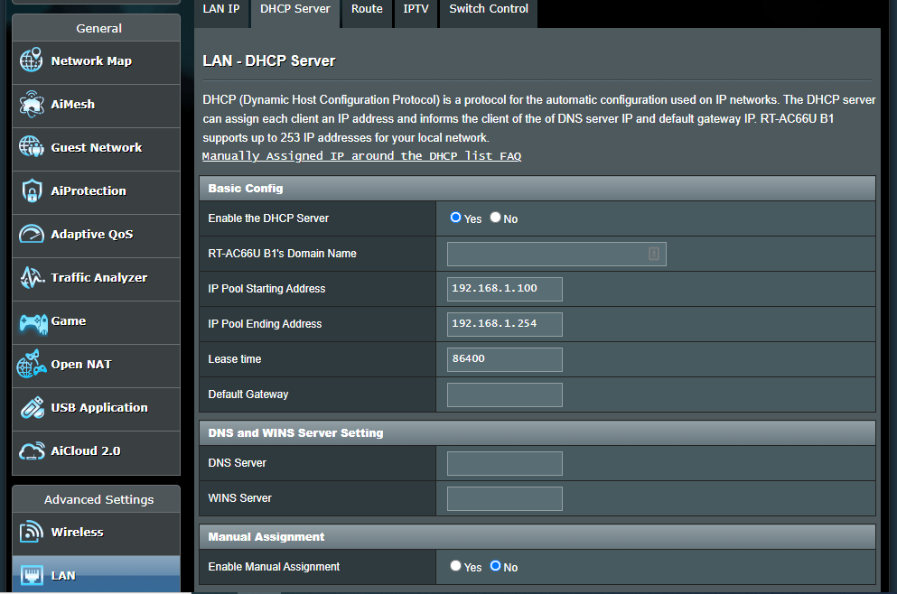

The DHCP Server is an ASUS Router (RT-AC66U B1).
