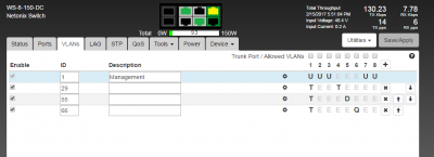

QinQ and Double Tagging should be fixed in 1.4.7rc9, which should be available soon.
Additionally, you should now be able to do a setup like this:
In this example port 1 is the upstream connection, either directly to another switch or via a radio or something.
You can access the management interface of the switch using untagged frames on port 1.
Any devices connected to ports 2 or 3 will also send frames upstream untagged.
The device on port 4 must send tagged frames for VLAN 29, and those frames will be sent upstream unchanged.
The device on port 5 must send tagged frames for any VLAN, and those frames will be sent upstream after adding a second VLAN tag (VID 55, TPID 0x8100).
The device on port 6 must send tagged frames for any VLAN, and those frames will be sent upstream after adding a second VLAN tag (VID 66, TPID 0x88a8).
You should be able to add any combination of U,T,D,Q ports all with a T on port 1 and it should work as expected.

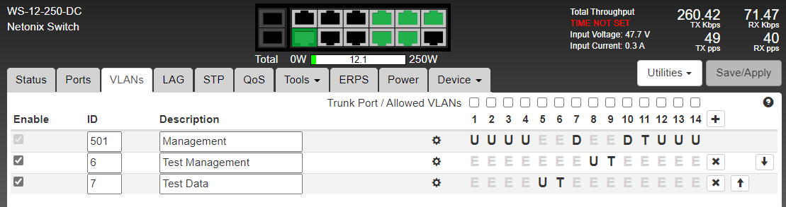

Tue Nov 17, 2020 11:42 pm
I gave up on this at the time, but this year, giving up was not an option. After reading another thread, I came up with this solution...
Port 8 = U VLAN 6
Port 9 = T VLAN 6
Port 10 = D VLAN 501
Physically connect ports 9 and 10 with a patch cable. Burning 3 ports to connect a single device. I'm loving it!
