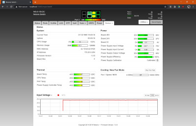

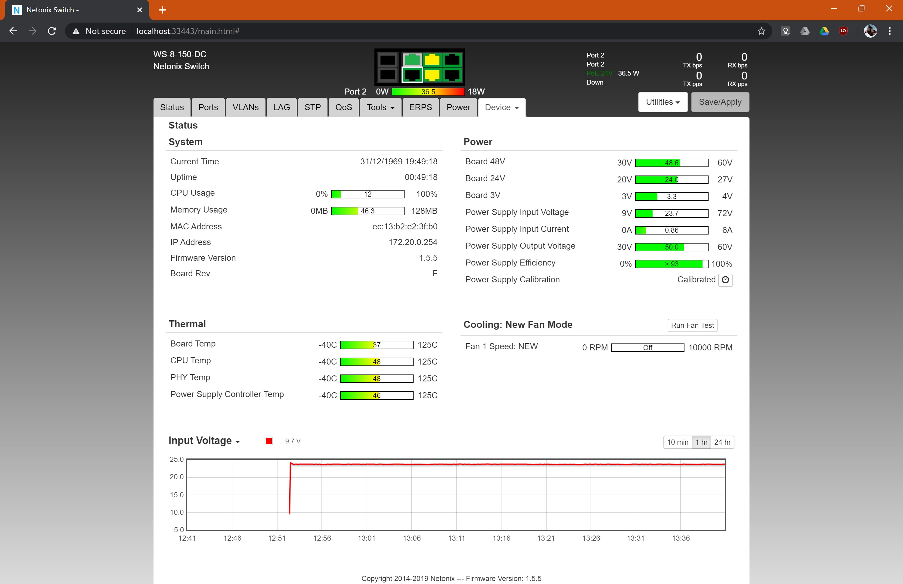

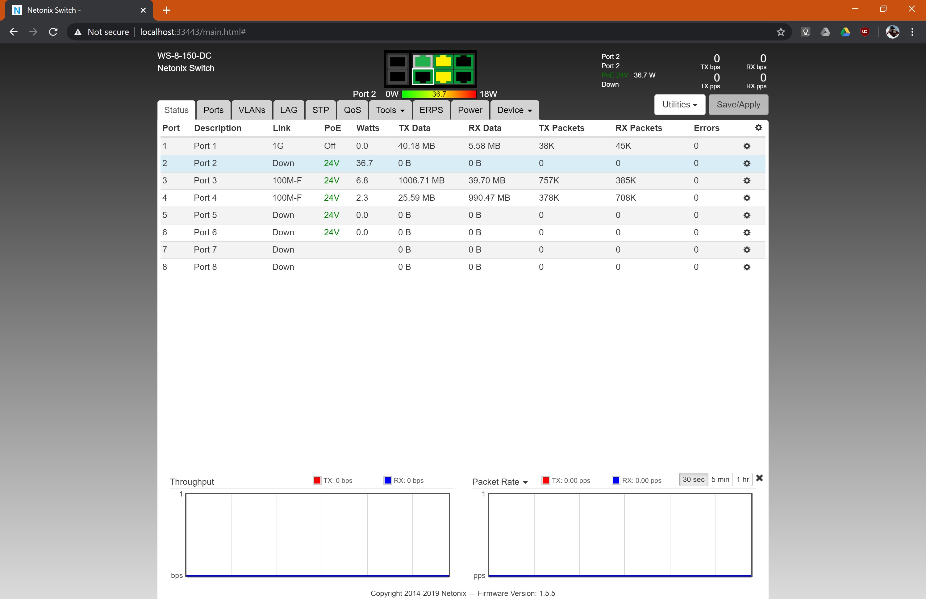

Status overview page
Power detail page

Your screen shot of the status page shows an input voltage of 23.7 volts and a current of .86 amps. That is around 20.4 watts so the reading on the port is obviously incorrect. First place I would look is checking the grounds and looking for a ground loop.

Thu Jul 09, 2020 2:29 am
I have exactly the same issue in 5 netonix switches, some ports are now showing 39watts, how can that be? can someone from netonix help us to fix this issue? tks
