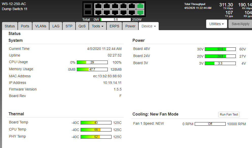

The title pretty much sums up my issue. Just installed a new WS-12-250-DC, and it is showing up in the GUI, and Netonix manager as an AC. Upgraded to 1.5.5 with no change.
Any ideas?

Yup, this means there was a corruption in the flash mem for the switch definition's.
It's actually not hard to fix though.
We need to setup a remote call at which point I will need to make a teamviewer session with a computer that can access the switch (either by ssh or by the rs232 console port) and I will need about 10 minutes to correct the issue.
Let me know what your schedule is so we can work out a time frame.

Thanks again for the help Stephen.

You're welcome Dawizman, glad it's working for you now.
