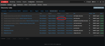

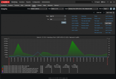

Re: Zabbix Template
This is what I see:
Do you have this in the Netonix Template Discovery?

Re: Zabbix Template
yes i have but they don't create graph.
do you have enable snmpv1 or snmpv2c on the netonix switch?
