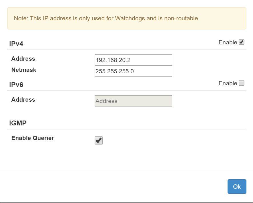

Try this, as I've had a similiar but not identical problem and this worked as a work round for me. Try assigning an IP to each of the vlan ports. Then apply that and try again?
