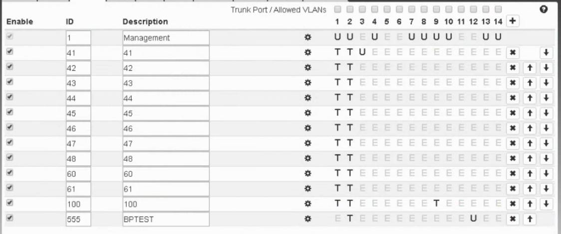

I use a range of Netonix switches, and I've found I have trouble applying new VLANs to some of them.
This has happened over a range of firmwares, though currently the switches are on 1.5.5
What I've found happens is I can often create a new vlan, but it won't pass traffic on the switch until I give it an IP address on that particular vlan. If I try and apply a vlan it will sit there applying the config for 300 seconds, then default to the prior config. This happens even if I give the switch a reboot before doing the changes.
In the log file I notice it keeps saying "starting NTP client" after adding each vlan to the firewall zone
It doesn't make sense so it could be something in my config maybe causing it to get confused. What should I post to help eliminate the issue?
Below is a copy of my log after it did take almost 300 seconds, but seems to of worked!

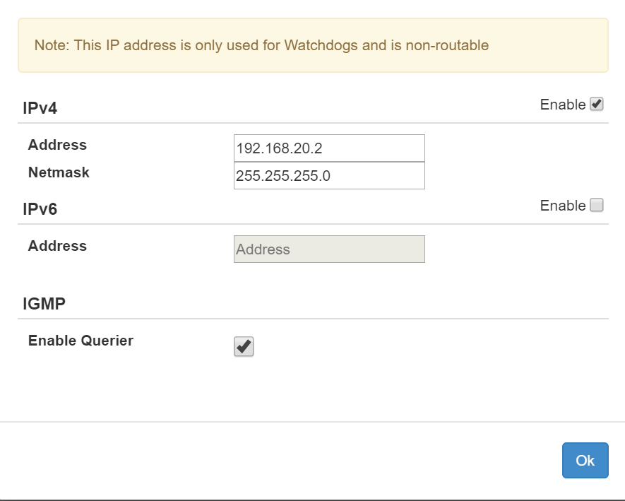

As far as the VLAN's needing an IP to pass traffic, can you double check this? I feel like if this was happening we would have heard of it long before now. What I think might be occurring, is if the first bug is correct. Then the VLAN's get reverted before the config is applied and thus eliminated so obviously any tagged traffic for the lost VLAN's won't pass.
What I suggest you try to test this is to create a small group of VLANs, small enough that it won't take long to apply them (maybe 3-4) And see if you can get them to pass traffic.
If that works than it is likely the symptom of a syncing issue with the config. Which I will investigate.

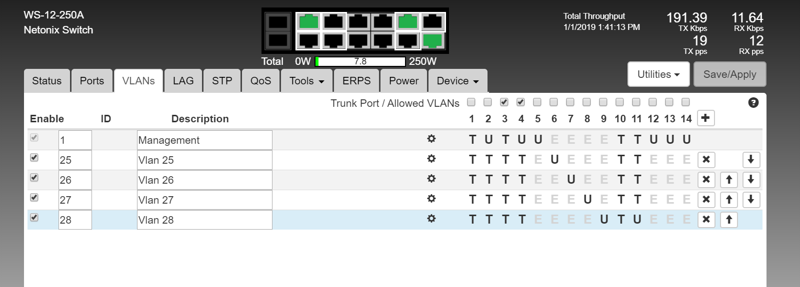

Hi Stephen,
Many thanks for the reply.. my logic is it must be something I'm doing wrong as pretty much exactly what you said, there's so many people already using these switches and vlanning that something obvious would show up way sooner.. the vlans not passing traffic unless assigned an IP was an issue I used to have a couple of years ago, and to be fair I haven't tested it again since, so I will lab something up this week.. the more perplexing issue was it failing to apply the settings and the fact it was happening across multiple switches.

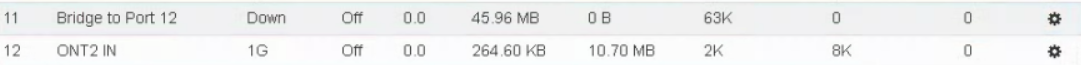

One other question, and may be related is I have a device connected to port 12 on the test bench.. and nothing plugged into port 11... and tagged traffic on port 2.. both ports 11 and 12 are untagged to form a bridge as such.. yet port 11 shows as moving a lot of data??? like gigabytes over the space of an hour or so.. there are no other vlans or untagged traffic on port 11 or 12... and port 2 has other tagged vlans and one untagged vlan (1) on it.. could this be part of the issue?? I'm wondering if having tagged and untagged on the same port isn't a good idea. If I change port 11 to tagged the same thing happens. Multicast is off.
Just to throw more confusion into the mix, if I make port 11 an untagged port, evenn thought there's nothing plugged into it, if I run a speedtest.net test, I get about 1/5 to 2/5 of the speed I get than if I disable the port.. I've also included a picture of all my vlans.. (I don't want to derail this thread into a training thread or anytihng, so if I should make this as a seperate topic elsewhere let me know)..

bpnz wrote:One other question, and may be related is I have a device connected to port 12 on the test bench.. and nothing plugged into port 11... and tagged traffic on port 2.. both ports 11 and 12 are untagged to form a bridge as such.. yet port 11 shows as moving a lot of data??? like gigabytes over the space of an hour or so.. there are no other vlans or untagged traffic on port 11 or 12... and port 2 has other tagged vlans and one untagged vlan (1) on it.. could this be part of the issue?? I'm wondering if having tagged and untagged on the same port isn't a good idea. If I change port 11 to tagged the same thing happens. Multicast is off.
This could potentially all be the result of this:
bpnz wrote:the more perplexing issue was it failing to apply the settings and the fact it was happening across multiple switches.
If when applying the config's, a revert was attempted by didn't work correctly. Then your switches actual configuration might be different then what is reported in the UI. This could lead to all sorts of confusion.
Probably the best way to troubleshoot this, is when you get a chance in the lab. Start with a switch that has been defaulted. Then apply a few vlan's (say 2-3) and see if they pass traffic, and all the stat's make sense.
If that works add a few more, repeat until say 6-8 in total. If that works.
Then clear them, and re-add them all at once.
My guess is that is when you add them all at once is when you'll start seeing issue's. If you can replicate that scenario, then it will give me something to hunt down.

Hi Stephen, I took the time to try it tonight.. my setup was a Edge Router 12P with a ETH port setup with a handful of vlans plugged into a switch with a laptop plugging into that, very simple.. I verified the laptop was working fine plugging it directly into the ER and changing the tag on the lan port on the laptop.
Everything was fresh, meaning the switches I used had a full factory reset and were running the latest firmware (1.5.5 installed THEN the factory rest performed). The Edge Router was running the latest firmware with a very basic setup for testing, basically I did a factory reset, created some VLANs and added DHCP servers where needed.
So just adding two vlans on a WS-8-DC-12 switch.. no traffic would pass through the vlans.. the laptop could not get an IP address.. I tried repowering the switch, laptop and Edge Router.. nothing could get it to work.. I even did an identincal setup on a Edge Switch (that worked first pop)... The Netonix refused to work UNTIL I assigned an IP to the vlan on the switch.. then it worked perfectly.. VLAN traffic would only work on the VLANs I assigned IP addresses. As soon as I disabled those IP addresses it stopped.
I grabbed a WS-12-250A switch... latest firmware, factory reset.. and had exactly the same issue..
The two pictures below are from it working.. the picture of the vlans, I can plug the trunk from Edge Router into any of those four and it works.. I know the EdgeRouter and laptop are fine as I mentioned above the laptop plugged directly into the same ETH port on laptop with the tag added on the laptop worked perfectly, and it worked perfect with a Edge Switch. In both cases the laptop was able to get an IP via DHCP and browse the web.
The revert delays were set to 300 seconds and it didn't once get anywhere near hitting them.
You mention above if it didn't apply the changes properly the UI may be displaying the wrong config? but I'm assuming with at least a refresh of the webpage or a reboot of the laptop and switch then the UI and switch config would sync up??

I have seen this before. Oddly not on all switches. Everything is running 1.5.5.
One of our switches (a WS-12-250-AC) does this where VLANs will not pass through the switch until an IP address is added in the VLAN.
I just verified that one of the VLANs did not have an address and ping was broken. I added an address and now I can ping devices on that VLAN through the switch.
The save of the config with just adding that IP took a long time (300 second timer was down to low 200s - normally takes a couple of seconds to save).
Disabling the IP on the VLAN and hitting save again took around 100 seconds... and pings continued to work... and ping continued to work after rebooting the pass-through switch and the switch that the device is local to (I would suspect the MAC address is still in another switch or the router).
