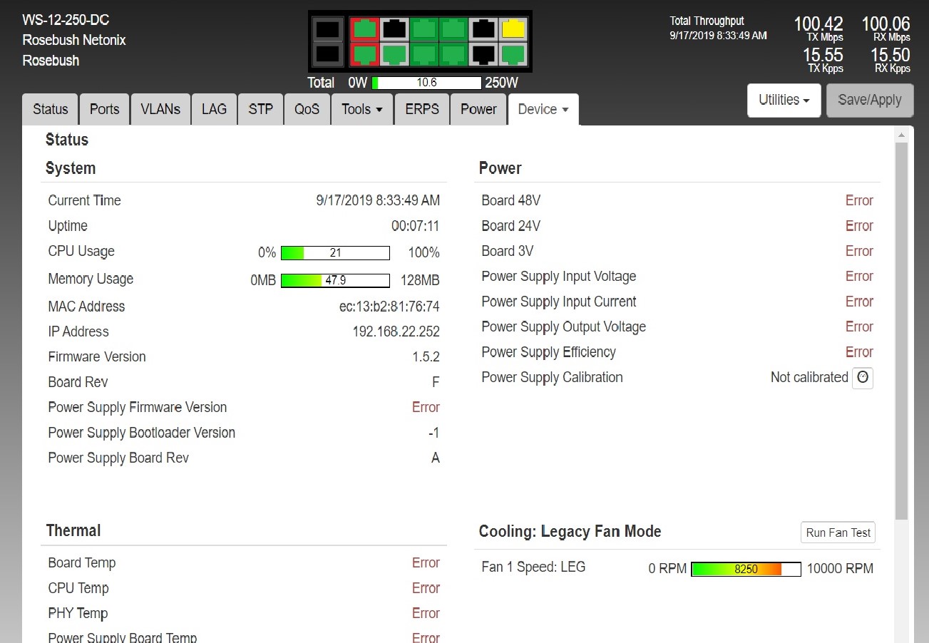

Noticed this in one of my switches this morning. Had a power outage the other day and the batteries did go the expected run time. Anyone seen something like this before? Not sure if Switch, P.S. or bad battery(s).
Re: Voltage and Thermal Errors on Status Page
Try a UI reboot but if no joy do a power cycle - SHOULD FIX IT
If not then you can try opening the chassis and checking the I2C cable between power supply and switch, if still no joy then down to RMA but think reboot or power cycle will fix it as this sometimes can occur.
Also take this time to upgrade firmware
