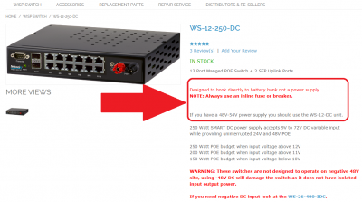

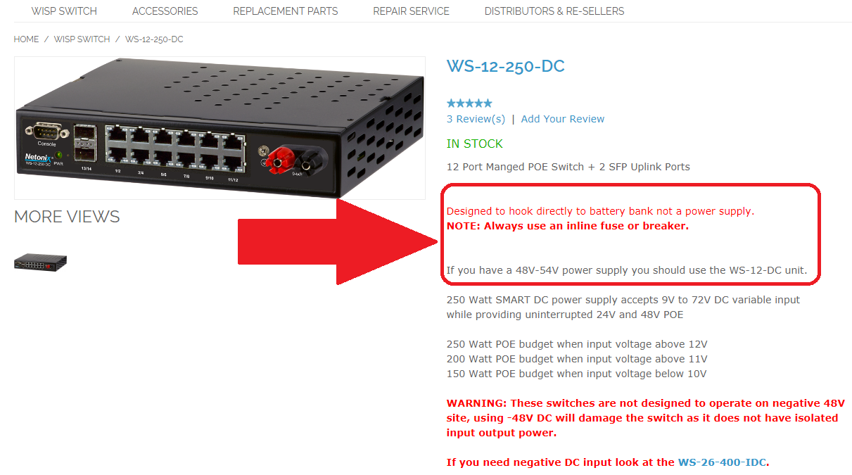

Why would you use a WS-12-250-DC and then power it with a power supply?
The WS-12-250-DC is designed to hook DIRECTLY to the battery bank with an inline fuse or breaker.
READ THIS POST: https://forum.netonix.com/viewtopic.php?f=6&t=4450&p=27007&hilit=+heaven+forbid#p27007
This is stated all over the forums and on the product description.
If you want to use a power supply then use the WS-12-DC switch not the WS-12-250-DC
But lets think about this, the WS-12-250-DC power supply is rated at 250W but is really more (we under rated it), and the power supply you are using to power that power supply is only rated at 150W........you do not see a problem here?
We do not recommend using our SMART DC switches with a power supply but if you do you should use a power supply rated LARGER than the switch power supply to deal with things like in-rush.
