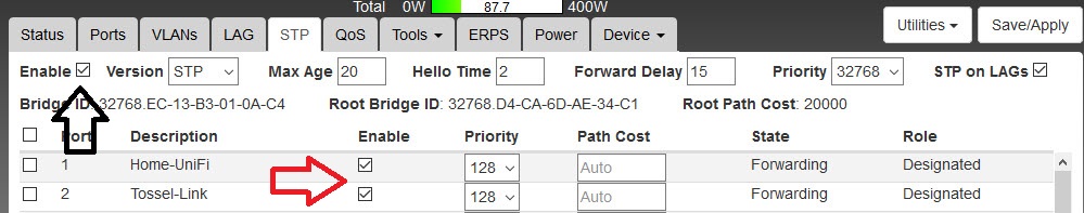

Do i just disable where the Black arrow is or do i also untick the boxes by the red arrow?
Thank you
Re: Connection disconnecting a cable knocks off PoE
You can disable it per port RED Arrow or whole switch Black arrow.
