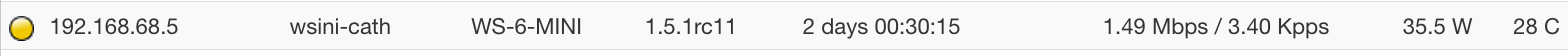

Hi,
We have a bunch of Netonix switches managed by Netonix Manager running under Linux.
It seems to work fine but switches whose names start with "ws6mini-site" appear in the Manager as "wsini-site". The "6m" is left out from the initial portion of the name, any idea why ? Could this be fixed please?

Can you post a screenshot?

Here's the requested screenshot
screenshot

I can confirm this is happening when I try to replicate the scenario. Keep an eye out for an update to the NM
