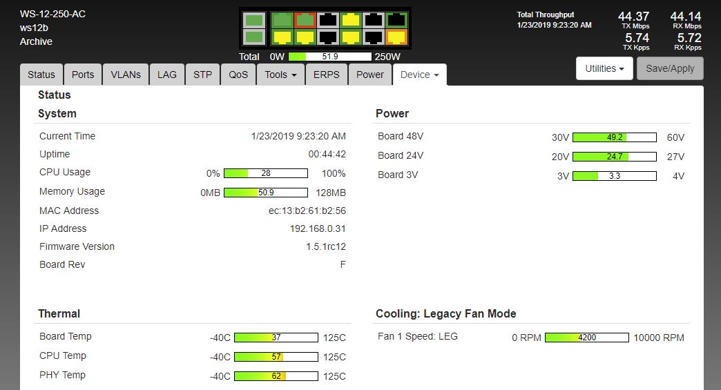

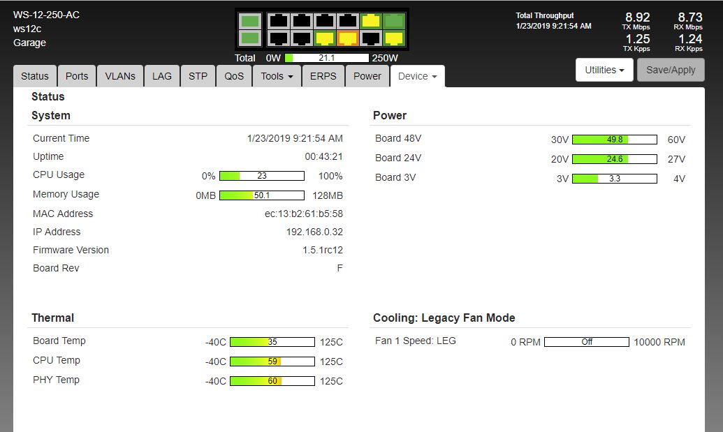

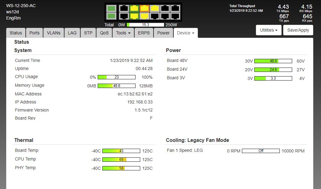

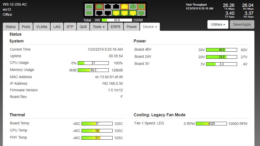

Upgraded to 1.5.1rc12 this morning and seeing some inconsistent fan behaviour.
Typically I can tell the seasons by the way the fans run on these indoor units, which is almost never in the winter and especially when it is this cold.
Currently: (lab = office/ws12)
Code: Select all
root@ubu:/Fedora# temps
Wed Jan 23 09:16:49 EST 2019
Wind : 0.2 m/s, 1.7 m/s max
Rain : 0.0 mm, 0.0 /hr; 0.0 mm/hr at 12:00:02
Baro : 1026 trending v
Outdoor : 3.4 67%
Archive : 22.1
Lab : 19.8 28%
Lounge : 19.5 24%
Garage : 6.4 43%
root@ubu:/Fedora#
Attaching screenshots for engineering.
These units are over a year old. Let me know if you need anything additional. Thanks-Jake
Re: v1.5.1rcX Bug Reports and Comments
Wed Jan 23, 2019 10:39 am
Fan controls changed, explained here: viewtopic.php?f=17&t=3914&p=27564&hilit=+fan+sunon#p27564
The release notes also tell you we had to change the fan controls.
jakematic
Posts: 168
Location: NC USA
Has thanked: 362 times
Been thanked: 87 times
Wed Jan 23, 2019 10:53 am
sirhc wrote:Fan controls changed, explained here: viewtopic.php?f=17&t=3914&p=27564&hilit=+fan+sunon#p27564
Oh I know, I read every post on the forum daily :)
Just wanted to let the guys know that some are running constantly now at 1/2 throttle while other warmer boards are at zero RPM.
May be nothing, but as an engineer I notice these things.
Wed Jan 23, 2019 11:08 am
Board temp has to drop to 35C for fan to turn off, always was 35C that has not changed.
The fan used to kick on at 40C board temp and now waits till 45C which was a compromise as we had to change low speed from 3K+/- to 4K+/- due to the NEW fan specs.
There are other things that can cause the fans to turn on but they cause the fan to go to HIGH speed of 8K+ regardless such as CPU/PHY/DC power supply sensors
