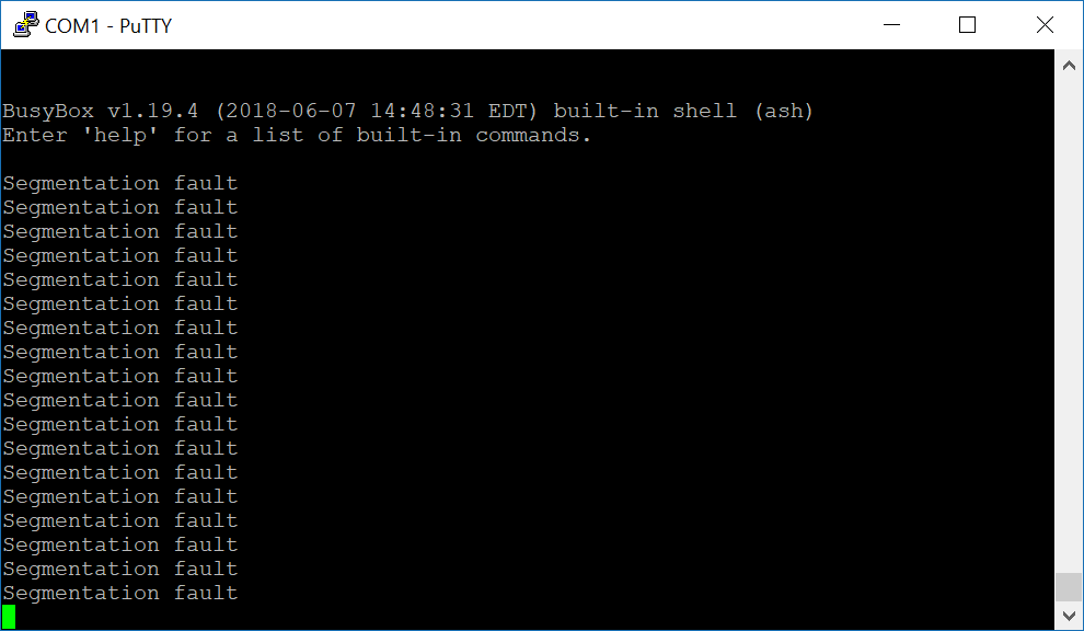

I can't do anything with the two dead WS-6-MINI switches but I connected a console cable to the WS-8-150-DC and it just repeatedly says, "Segmentation fault" infinitely scrolling, (screenshot attached). If you'd like me to send you the switch for a 'post-mortem' I'd be happy to do that. Otherwise I suspect this will be one of those faults which is so difficult to reproduce that it might be impossible to fix.

Well the segmentation fault "sometimes" can be fixed with a power on factory default: viewtopic.php?f=6&t=409#p2398
If that does not work and it has a console port then you can try a console firmware recovery: viewtopic.php?f=17&t=1073#p8073
If no love from above then RMA them as it is a simple re-flash, and we will do a checkup of the unit and fix anything else we find wrong and apply any hardware MODs for a reasonable fee.
You can import configs from other models so long as same firmware version, and if importing say a 6 port to a 12 port you may need to do some touch up in the UI such as VLANs.
Importing configs from a higher density port to a lower density port should result in losing any config for higher ports not present.
Yes the config files are JSON and some people do modify them with scripts - I suggest not as JSON is not forgiving if 1 character is out of place.
