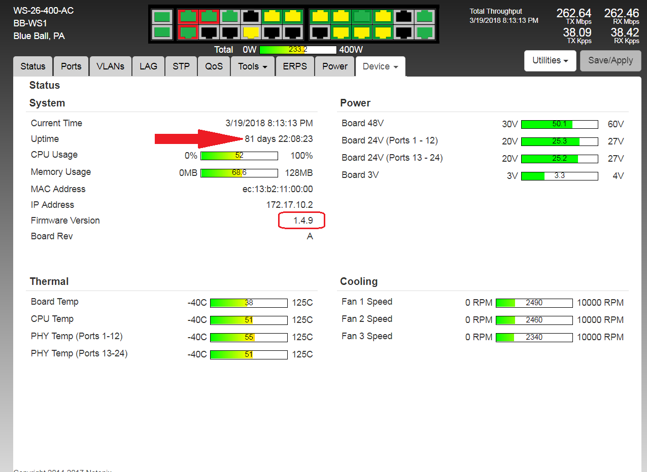

There was not an issue found that would cause WS-26-400-AC to reboot.
We are suspecting the WS-26-500-DC was rebooting due to HIGH CPU utilization keeping track of all the telemetry which we optimized cutting CPU utilization in half. This actually reduces CPU utilization on ALL models but the CPU was never too high on other models to affect things.
If the CPU utilization gets to high it can trigger the watchdog and reboots the switch.
If your seeing a WS-26-400-AC reboot which I have several in service and this has never been an issue then I would suggest further investigating them for other possible issues.

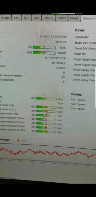

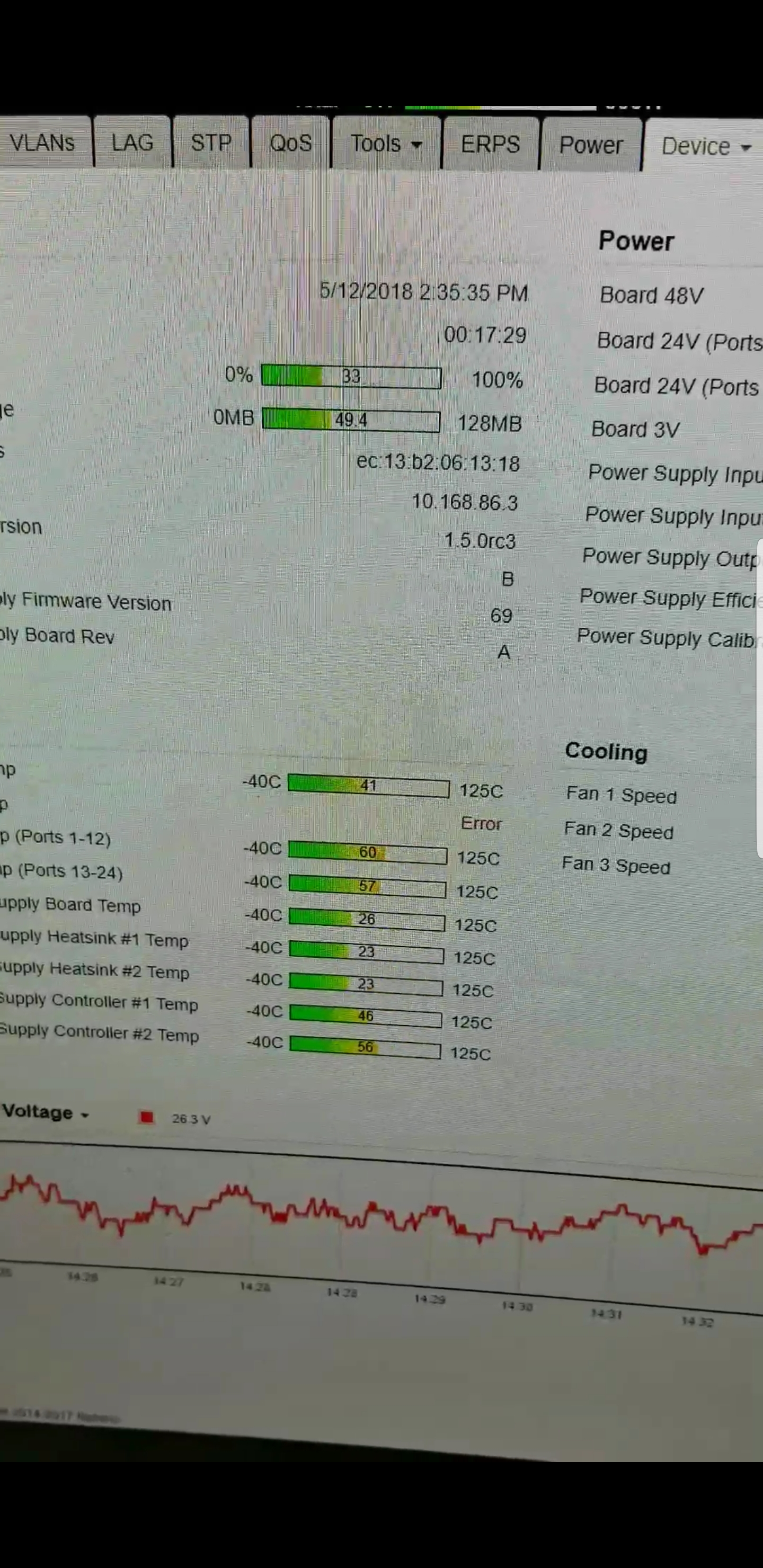

Yesterday I swapped out a WS-12-250-DC for a WS-26-500-DC. The WS-26-500-DC has been on the shelf in the box for several months. Today it rebooted with less that 24 hours of uptime. The WS-12-250-DC that was there never rebooted and had almost a year of uptime.
If I order a newer unit from you will the problem be corrected? This is a mission critical site that can't have this happen. Would you recommend for now that I just use 2 WS-12-250-DC instead?
Edited to add: Firmware is 1.5.0rc3 right now.
Another Edit: Looks like I am having I2C cable issues. Errors are popping up randomly. Should I just try rerouting the cable to see if it helps?

1) yes all units in USA Distribution channels have been corrected. And yes I would check/fix the I2C cables.
2) Upgrade to v1.5.0rc4
3) The reboot could or could not be the switches fault. For instance how are you powering the WS-26-500-DC, is it connected directly to battery bank or a charger/power supply?
If you purchase a spare and swap out and problem goes away then RMA it.
