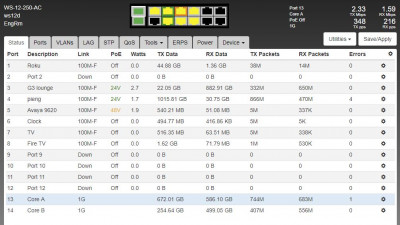

An SFP reset happened this morning and port 15 is mentioned in the log.
Not sure if that is the LAG or a port numbering error in the code.
Recall there was a numbering issue at one point, but couldn't find anything similar in other posts.

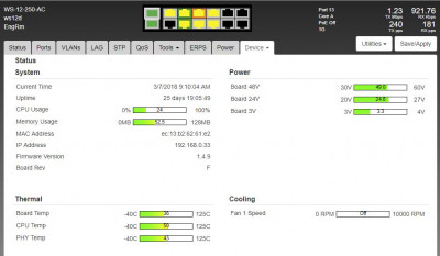

Version 1.4.9, Board rev F
Code: Select all
Mar 7 08:10:15 SFP: FAULT on SFP 0, resetting...
Mar 7 08:10:16 SFP: FAULT on SFP 0, resetting...
Mar 7 08:10:17 STP: set port 13 to discarding
Mar 7 08:10:17 STP: set port 14 to discarding
Mar 7 08:10:17 LACP: LACP changed state to Active on port 13 (key 4)
Mar 7 08:10:17 STP: set port 15 to discarding
Mar 7 08:10:17 switch[1286]: LACP changed state to Active on port 13 (Core A) (key 4)
Mar 7 08:10:18 STP: MSTI0: New root on port 15, root path cost is 10000
Mar 7 08:10:18 STP: set port 15 to learning
Mar 7 08:10:18 STP: set port 13 to learning
Mar 7 08:10:18 STP: set port 14 to learning
Mar 7 08:10:18 STP: set port 15 to forwarding
Mar 7 08:10:18 STP: set port 13 to forwarding
Mar 7 08:10:18 STP: set port 14 to forwarding
Mar 7 08:10:19 sSMTP[1289]: Creating SSL connection to host
Mar 7 08:10:20 sSMTP[1289]: SSL connection using AES256-SHA
Everything is working fine, just never saw that port # before.
