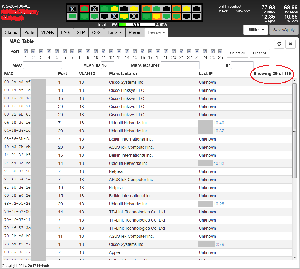

I've been chasing an issue for several weeks and narrowed the problem down to unicast flooding. The switch is forwarding traffic out to all CPEs on a VLAN because (from what I can tell) the MAC table is not populating correctly. Has anyone experienced this?

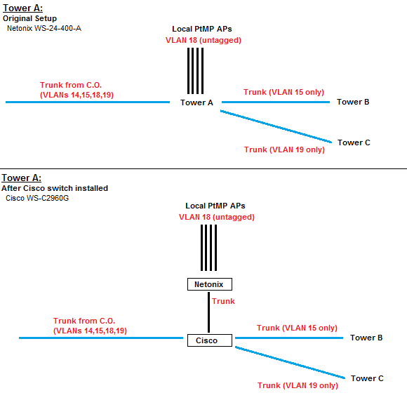

Setup is layer 2 and pretty straight forward:
Trunk from our C.O. (central office) is feeding the tower (A) that had the issue. I'm also feeding a few other towers (B & C) on different VLANs.
I have about 130 customers (split between 6 RocketM2 and a few dozen on 6 Rocket-5AC) on tower A. All APs and CPEs are in bridge mode and on VLAN 18. Customers have their own routers and we use PPPoE.

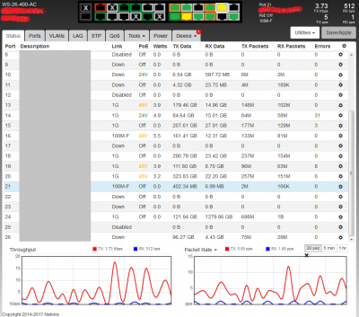

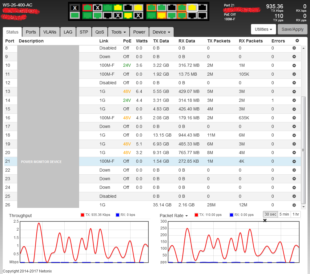

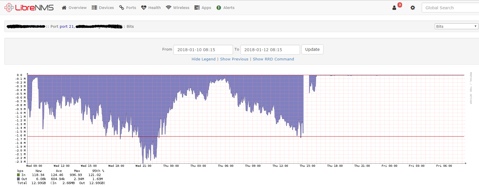

I have a RoomAlert that monitors power running on port 21 on the same VLAN. Normally I see very little traffic (20kbps or less) on this unless we load the webUI to look at the status. As you can see below the switch is sending unicast traffic out of this port as well.
Originally the switch was running older firmware and I upgraded to the latest (1.4.9) to see if there was a bug. This did not help so we replaced the switch with a newer model. The new switch didn't fix the problem either.

I had no choice other than to install a different switch. The switch installed now is a Cisco 2960. Everything was moved to the 2960 except for the local PtMP APs (they remained on the Netonix). The Netonix is uplinked (port 24) to the 2960 and set as a trunk.

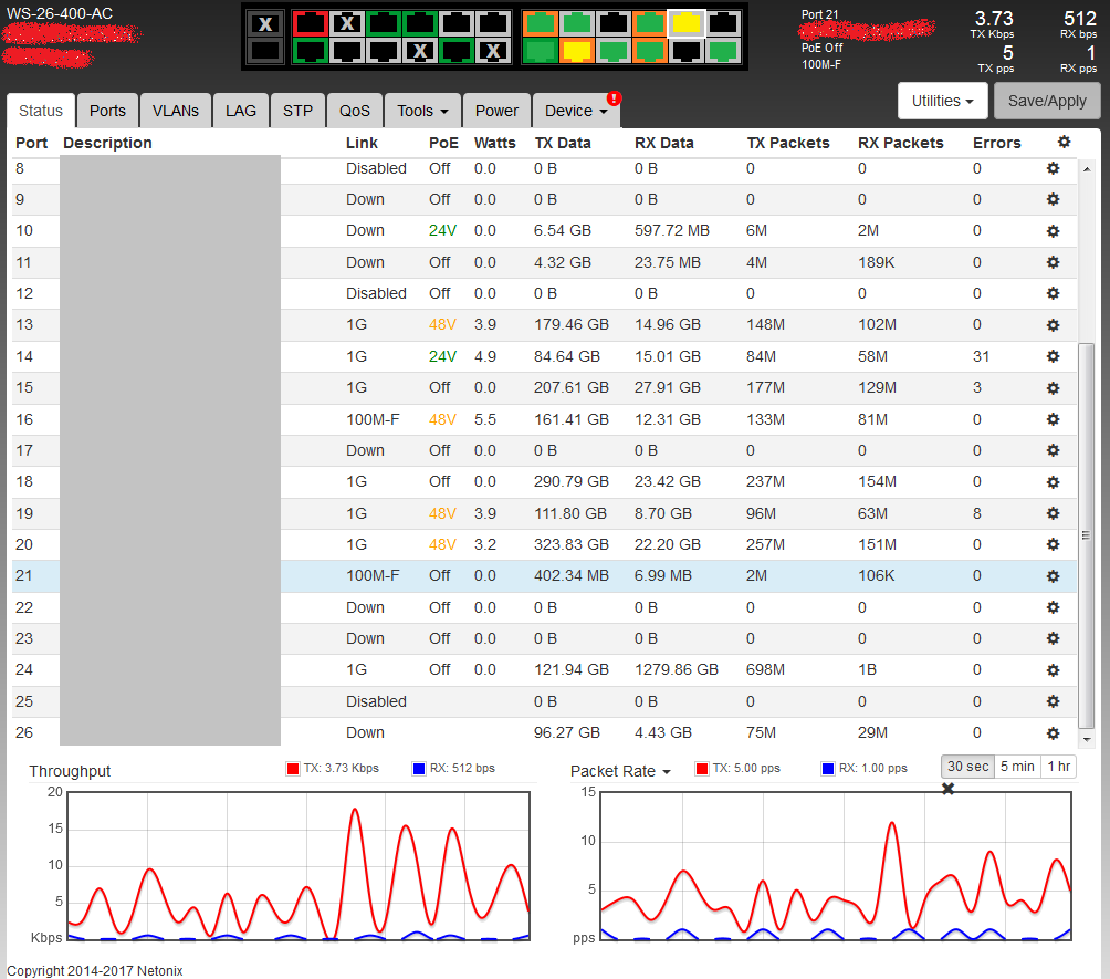

After this change the unicast flooding stopped. Below are several screenshots.

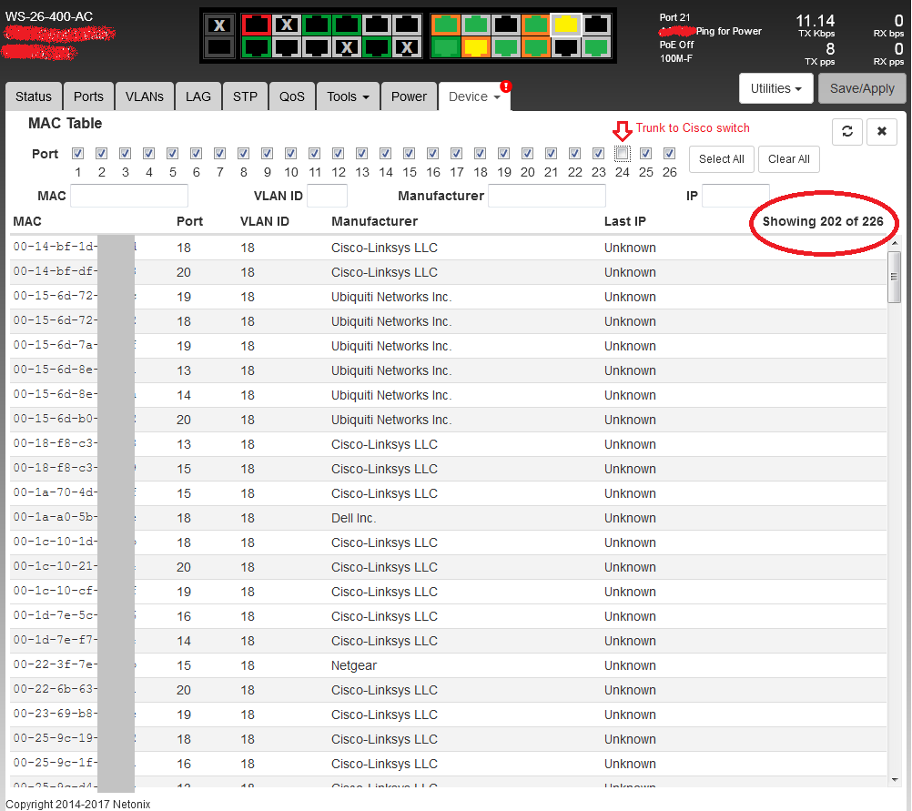

I also took screenshots of the MAC table. First screenshot is before the 2960 was installed and the second is after.
Notice, with all devices off of the Netonix other than the PtMP APs (on VLAN18) the MAC table is populated correctly.

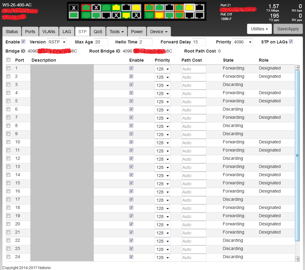

I have also attached a few more screenshots of different tabs in the Netonix to give a better understanding of the setup.

My first thought is that you have trunking enabled on ports 4 5 and 26 and that might be incorrect. But I'm not a VLAN expert.

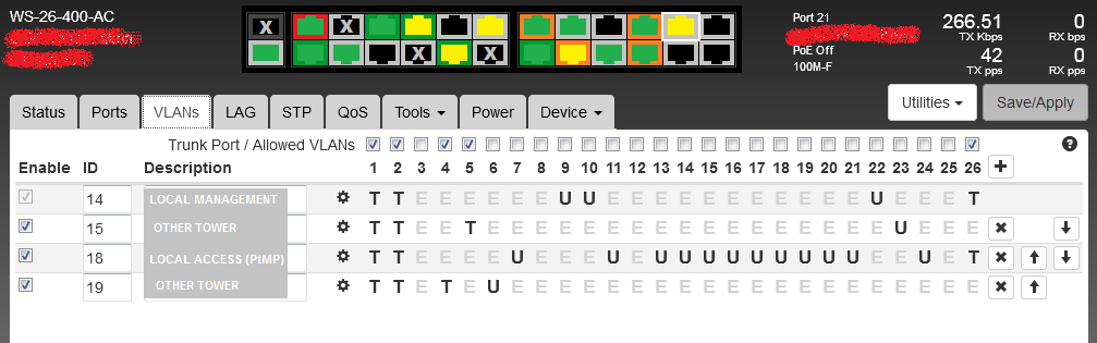

Ports 4 & 5 are going to two other towers (B & C). Trunking is enabled and only the specific single VLAN was allowed through. Port 26 is connected to another Netonix at the top of the tower with two VLANs allowed through (switch management and access).

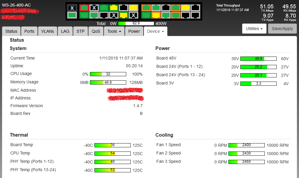

One observation is your running v1.4.7
Please upgrade to current version which is v1.4.9
- adunlap
- Posts: 4
- Joined: Thu Jul 28, 2016 10:30 am
Re: MAC table not populating correctly with multiple vlans
Sorry, but I already tried v1.4.9 on the SW-24-400A as stated above...
"-Upgraded firmware on WS-24-400A from 1.4.6 to 1.4.9. No fix"
"-Replaced with a WS-26-400-AC which had 1.4.7 pre-installed (did not upgrade to latest). No fix"
