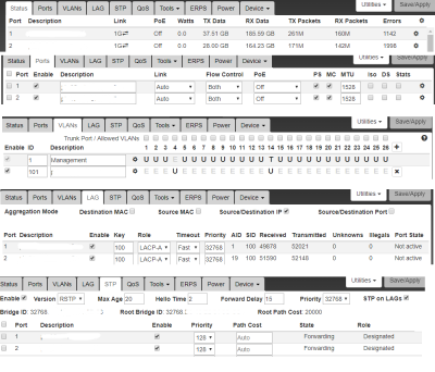

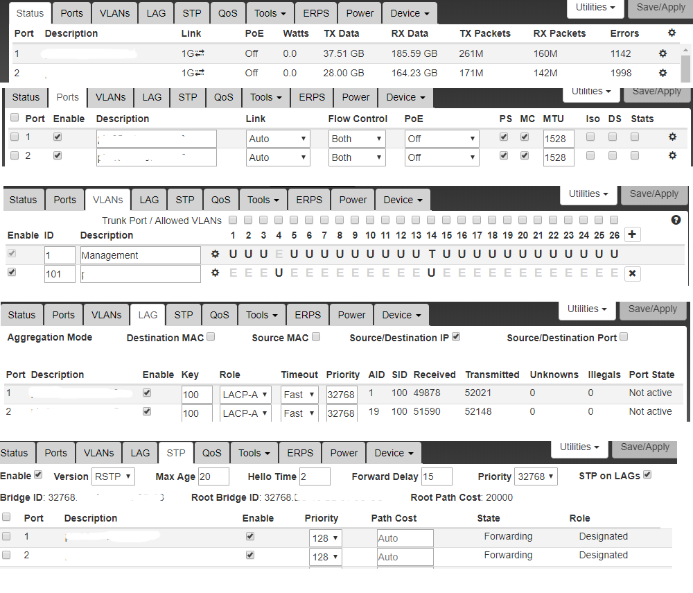

WS-26-400-AC switch connecting to a CCR1009, here are the tabs for the ports with the issue:
Log file - 100's / 1000's of these:
Dec 11 21:07:51 LACP: LACP changed state to Active on port 1 (key 100)
Dec 11 21:07:51 switch[2866]: LACP changed state to Active on port 1 () (key 100)
Dec 11 21:07:53 sSMTP[2871]: Sent mail for xxx@excel.net (221 Service closing transmission channel) uid=0 username=xxx outbytes=574
The ports are connected with 3' CAT6 cables in a rack.

Was able to perform more diagnostics on this over the evening. Cable swaps has no affect on the situation. During this though we noticed one of the ports (not part of the LACP group) had much higher response times than the others. It was connected to a Cambium ePMP 2000. When that device was power cycled ALL of the issues went away!
Now, why would this happen? Seems there is some sort of issue that a single port could affect other ports so significantly.

Re: v1.4.8 Bug reports and Comments
lweidig wrote:Was able to perform more diagnostics on this over the evening. Cable swaps has no affect on the situation. During this though we noticed one of the ports (not part of the LACP group) had much higher response times than the others. It was connected to a Cambium ePMP 2000. When that device was power cycled ALL of the issues went away!
I am thinking this has something to do with STP?
You should disable STP on ports facing AP's, and make sure STP is disabled in the radio itself:
viewtopic.php?f=6&t=2748&p=19018&hilit=+RSTP+disable#p19018
viewtopic.php?f=17&t=1480&p=16549&hilit=+RSTP+disable#p16549
viewtopic.php?f=17&t=1480&p=11011&hilit=+RSTP+disable#p11011
