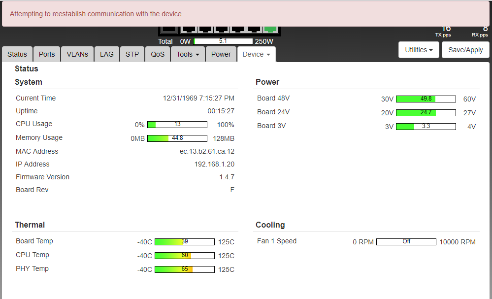

I've unpacked a new WS-12-250-AC switch, and unfortunately it keeps rebooting without any obvious reason.
When initially powered up it will sit idle fine for approximately 10-15 minutes. During this time I can log into it with my computer and the system status screen shows normal readings. It will then simply reboot.
After the first unexpected reboot, it will then reboot approximately every 2 minutes or less.

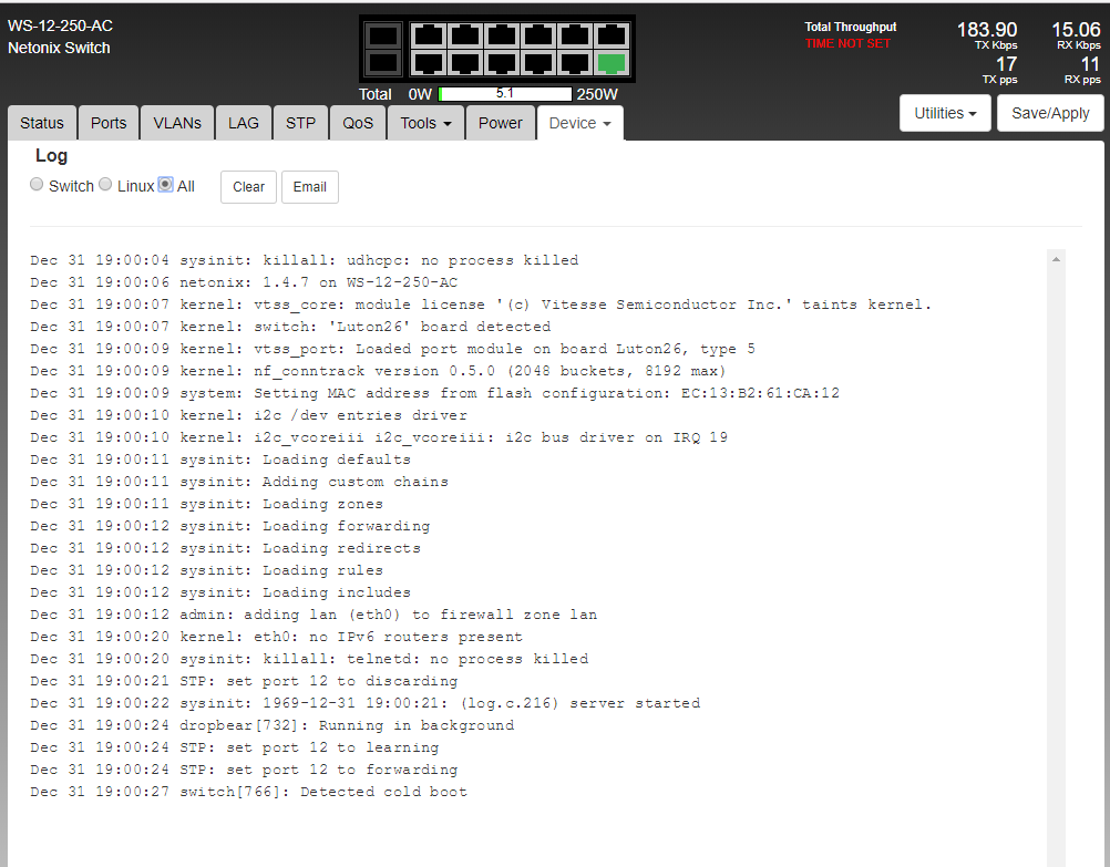

When the switch boots back up, I can't see any errors in the in the log.
