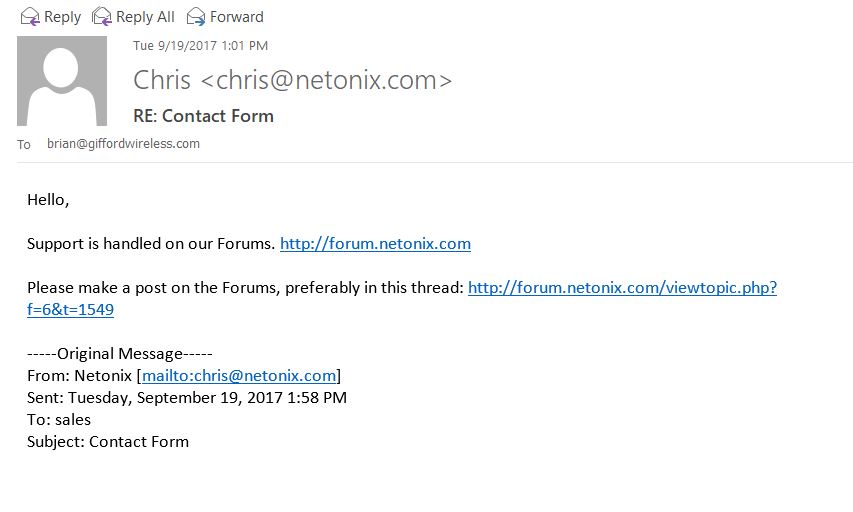

Then you aren't looking at your emails. Funny now?

bhesterberg wrote:Then you aren't looking at your emails. Funny now?
That email was from Chris. How does that relate to Julian?
