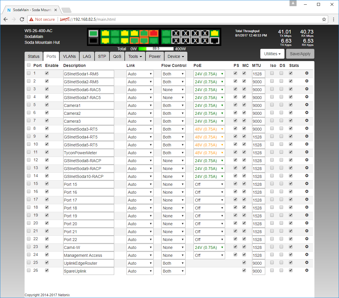

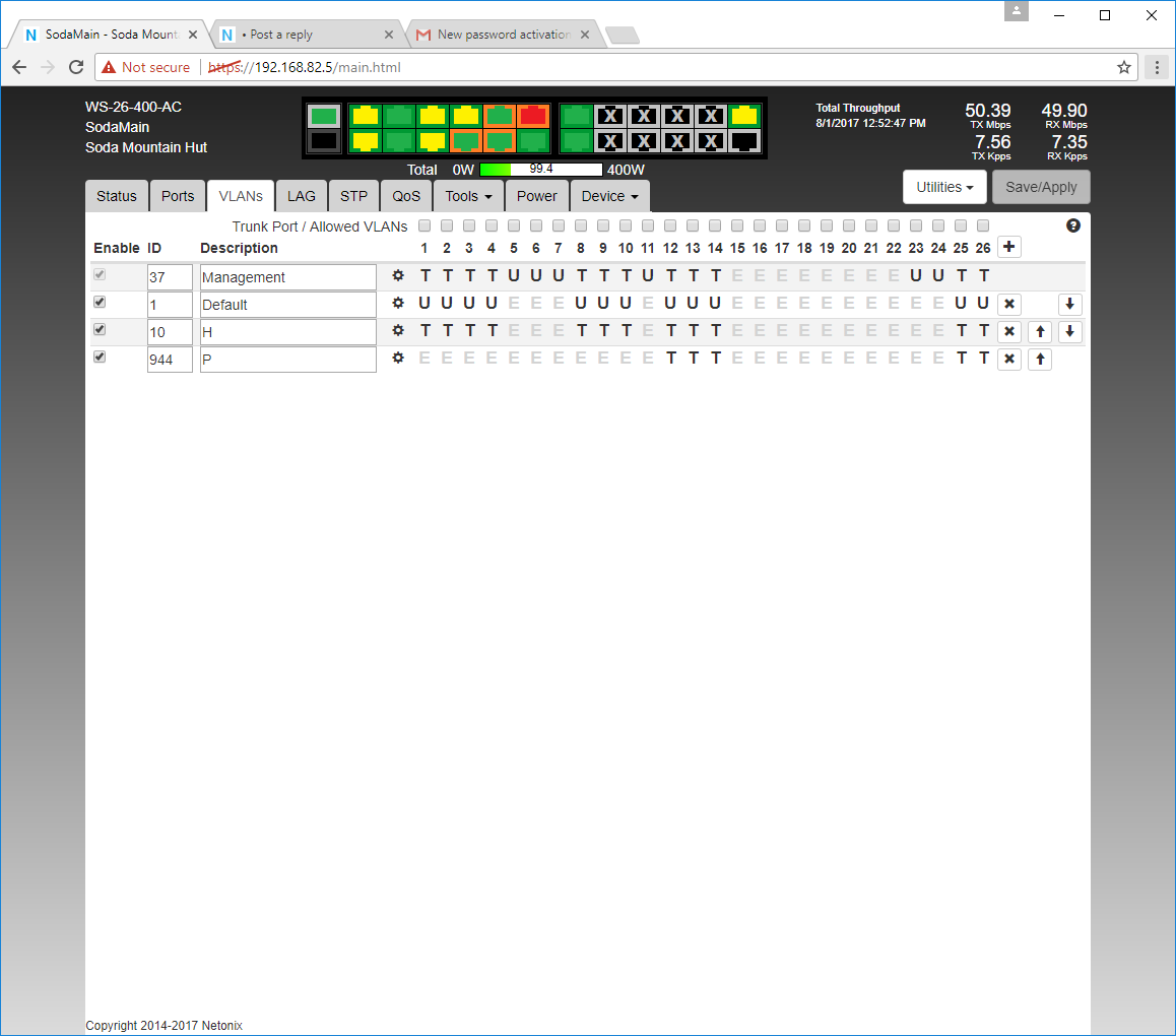

Re: Switch stops forwarding traffic..
Please post up screen grabs of all you Config TABs
Do you have port's SPeed/Duplex set to Auto? <== SOUNDS LIKE NO
Turning OFF FC should not cause this.
holbor - Member
- Posts: 4
- Joined: Wed Jan 13, 2016 5:46 pm
- Location: Scenic Rogue River Valley, OR
Duplex is Auto.. Images attached. Everything else is pretty much defaults.
