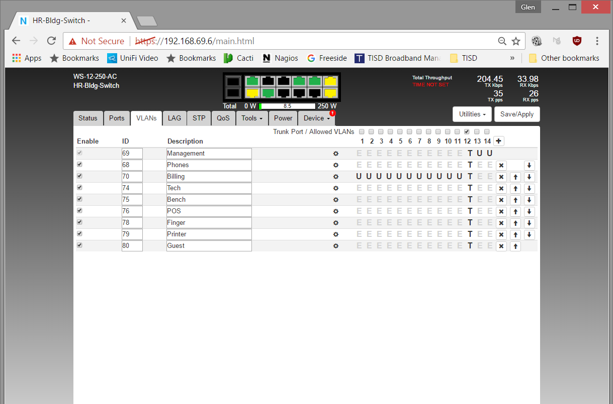

The original switch was just an unmanaged netgear 10/100, so there are a few changes from the original configuration. When we installed the Netonix we changed the uplink to a trunk so we could send some other VLANs over to that building. But since this is local traffic on the billing VLAN I don't believe that would have an affect. All three of these machines are on the same subnet and switch (well, until I added the old switch back into the mix).

Your VLAN setup makes absolutely no sense to me??????
So since the previous switch was a DUMB switch why not start out the same way to see if speed issue is still there.
But seriously your VLAN setup makes no sense to me.

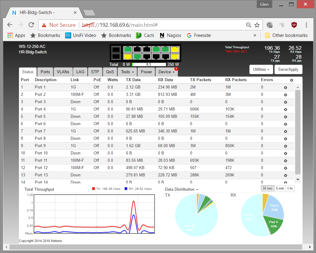

Post up your Status Tab please
And ports 2, 11, and 12 are getting 100 Mbps links???
I would do cable diagnostics on those ports and figure out why.

I'm guessing it makes no sense because the only VLAN we are currently using over there is the VLAN 70 (and 69 for management of the switch). The rest of the VLAN's were setup for future use. Is that a correct assumption on the confusion of the VLAN configuration?
Ports 2, 11 and 12 are currently 100mb devices. Port 2 was originally the QB Server which did link up at 1gb when it was plugged into the Netonix. Port 2 on the Netonix is now the old 10/100 Netgear switch with the QB server connected behind it (which is why you see it linked at 100mb).

Here is the status page.

Well I am going to "guess" you have a ton of Pause Frames or errors on 1 or more ports
I can not tell as I have requested you post up Port Details and you have not yet done so.
Yes I would try and get the server connected to 1G not running through a 100M switch
You could try disabling Flow Control on all the ports and testing.
WHat are the devices on ports 11 and 12

On the uplink in port 12 you are tagging vlan 70, which didn't happen with the unmanaged switch. Is the equipment connected to port 12 reconfigured for the change, or was it not in use before?
Maybe the server in port 2 is trying to access e.g. a DNS server (to log the name from an rDNS lookup) behind port 12 which it can no longer reach because the equipment on port 12 is expecting it to come untagged. You then wait for a DNS timeout on the server for a couple of minutes before continuing at full speed.
