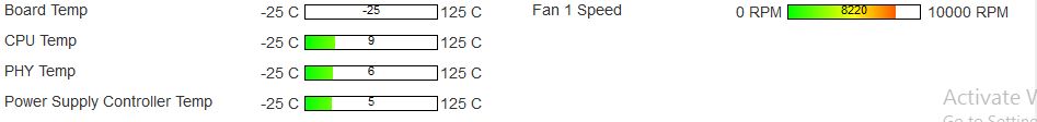

Cold temps WS-8-250-DC Power Supply Board Temp 4 million deg

we do have new test code for this issue...let me get Eric to send to you.
Re: Cold temps WS-8-250-DC Power Supply Board Temp 4 million
Tue Jan 03, 2017 1:52 pm
I went ahead and released v1.4.7rc3 which should fix temp issue.
viewtopic.php?f=17&t=240&p=848#p848

The temperature did get fixed with the update to v1.4.7rc3. It has been up for 35 minutes since upgrading and I still have high cooling fan speed (perhaps heating fan at this temp) .

thanks for the quick post...yup, seems we still have minor issue to fix...we will have rc fix for fans & Chris will post when ready.

please download wispswitch-1.4.7rc4.bin again & retry....think we fixed FAN issue now.

I updated the firmware to 1.4.7rc4. The fan had already turned off before I upgraded. Tonight is another cold night to test it out.

I haven't had an issue with the temperature or the fan since I upgraded to the 1.4.7rc4 firmware. :hurray:
