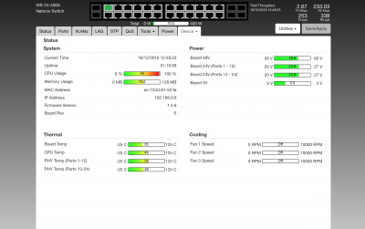

We deployed a new WS-24-400A a couple of days ago.
To start with we were seeing much better throughput than the tough switch it replaced.
However, yesterday I noticed the WebUI was refusing to load. A reboot failed (the switch did not come back on line), so a site visit was carried out this morning.
Pulling the power brought the switch back on but after a few minutes of operation CPU usage went up to 100% (and stayed there) and the gui was very slow to load.
Also the Total Throughput stats were reporting nearly 1Gbps of data through the switch - checking the devices connected to it they were all reporting 40-50Mbps.
I've upgraded to 1.4.6, defaulted the switch and manually re-entered the configuration. Same results - as soon as theres any traffic across one of the ports, the CPU jumps up to 100% and stays there even if all the cables are removed (obviously apart from a management link for me to use) and the webUi is slow and unresponsive.
Only a reboot restores a 'normal' CPU level.
The config is very basic - just a few VLANs and things like LAG, RTSP etc. all disabled.
I've attached a zipped copy of the config and screen grab showing the 100% CPU
Can you shed any light on what the problem is?

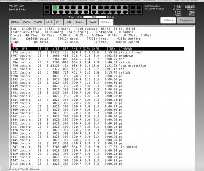

I'm back from our NOC and tried to reboot the switch remotely but its not come back online again.
I managed to screen grab a list of processes before I rebooted - see attached.
I note that the CPU % on the process list his different from that shown in the GUI. However the unbelieveably slow loading of the gui (e.g. the console took nearly 2 minutes to appear), would suggest the CPU is maxed out.
Have you any idea what might be going on?
