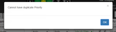

We cannot make any changes to the device due to this error message.

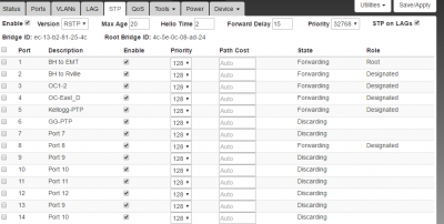

We were thinking it was STP as the priority was listed as the same there, but we received the message even when trying to disable STP.
LAG is disabled. The only other priority we can see is power, which is different.
It is currently running 1.4.4.
We have rebooted the device via Utilities. The error message persists and even shows up when no changes are made when we hit Save/Apply.
We have powered the device off via unplugging the DC power. When it comes back on it gave an error message "Invalid Fields" each time a change was attempted. It went back to the Duplicate Priority error once it was rebooted via Utilities again.
Any ideas?
"Cannot have duplicate Priority"

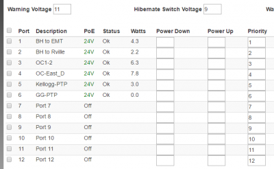

That message refers to the priorities on the Power tab. But the priorities on the Power tab look correct. So it must be something else.

The config actually has Priority values for ports 13 and 14 even though they are not shown in the UI. Somehow those values got set to 9 and 10, which are duplicates of the values for port 9 and 10, hence the error.
I'll send you a fixed config.
I'll also change the code so it ignores the values for ports 13 and 14 in the future.
