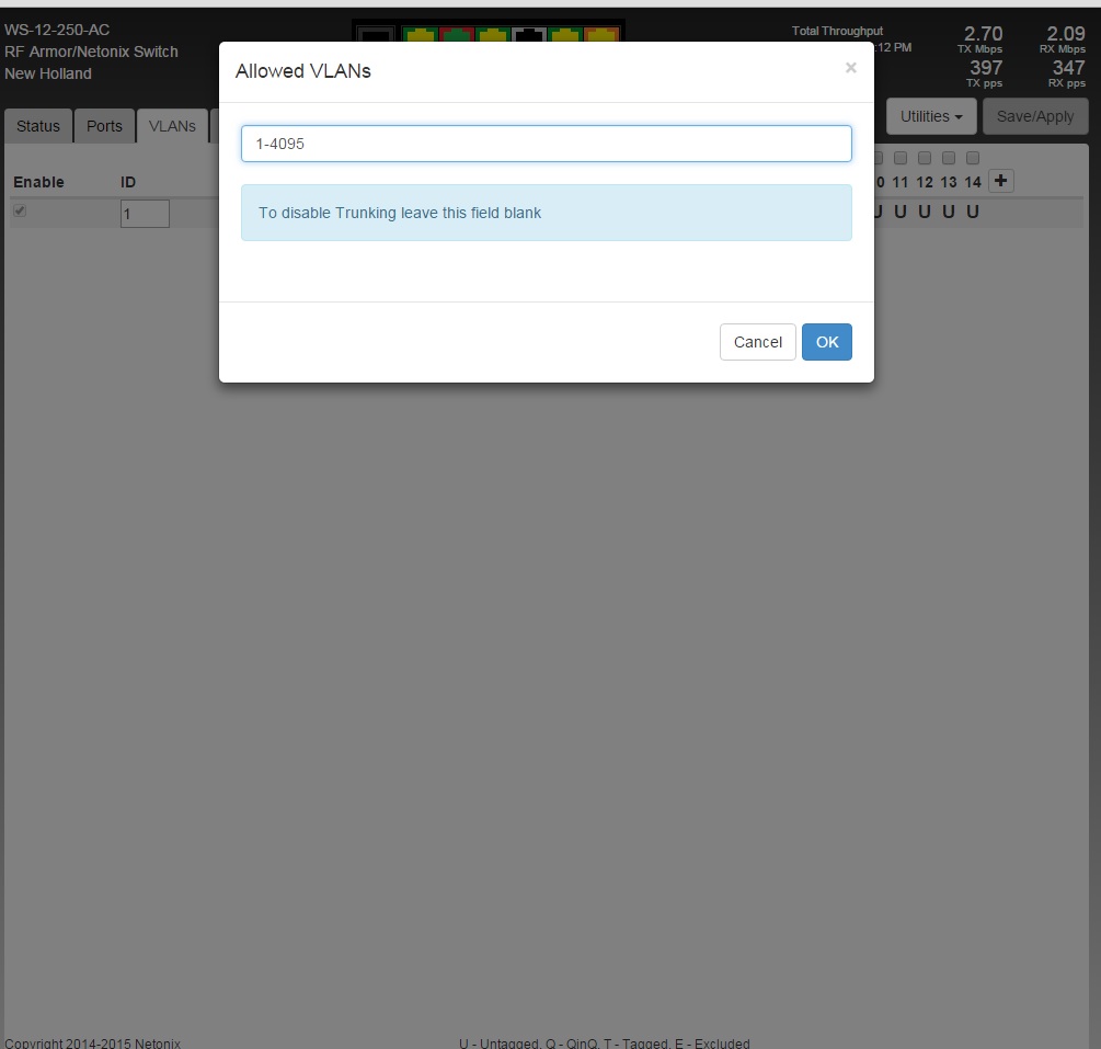

jready wrote:Just check back to see if we are going to have true Vlan trunking without having to list all the Vlans in the Matrix.
There is? Click on the Trunk Port / Allowed VLANs check box and a drop down appears where you can add the allowed VLANs
You can enter them in the input field like this: 1-100,150,2000-3500,3505,4000
Or leave the default which is all the VLANs 1-4095

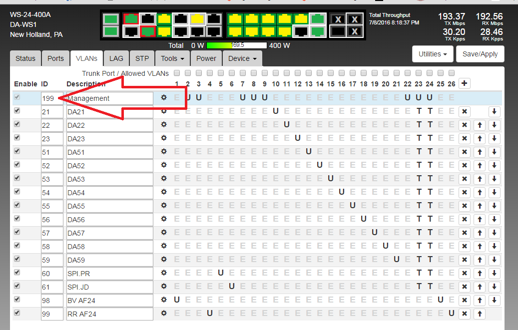

necesito cambiar la vlan de administracion, por default es 1, no veo ninguna opción para cambiarla por la interfaz gráfica.
Re: Setting Management Vlan?
Fri Jul 08, 2016 8:26 pm
The top VLAN the one that you can not delete is the Default/Management VLAN and you can simply change the ID to whatever you want.
In the below picture I changed it from 1 to 199
Not sure where your problem is?
