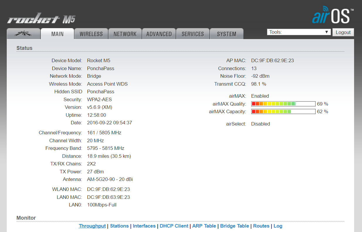

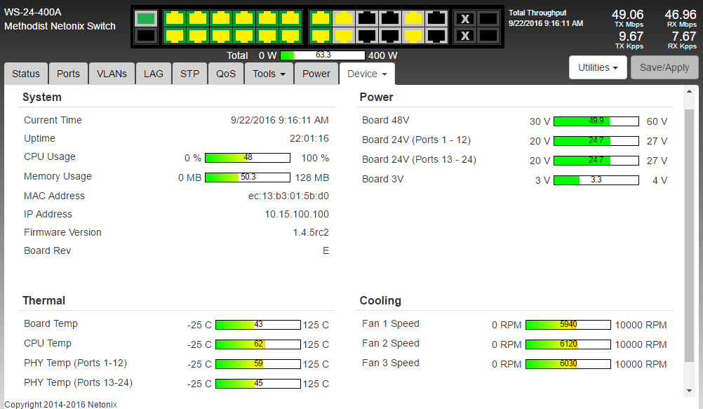

So just a little more info is all the devices are Ubiquity Rocket M5 access points, and we are connected to a TripLight 2400Watt UPS, the device is grounded to the tower blocks with solid 12g wire.
Re: Problem with some device randomly rebooting
kevinpez wrote:the device is grounded to the tower blocks with solid 12g wire.
I know you say the UPS ground lug is connected to the tower ground but is the AC service ground rods connected to the tower ground rods with a heavy #2 wire?

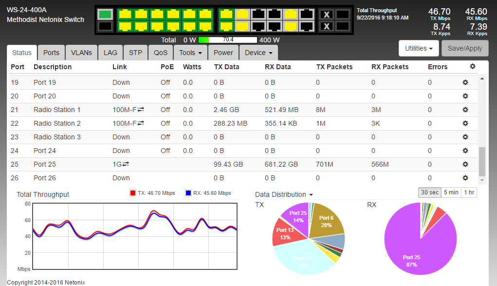

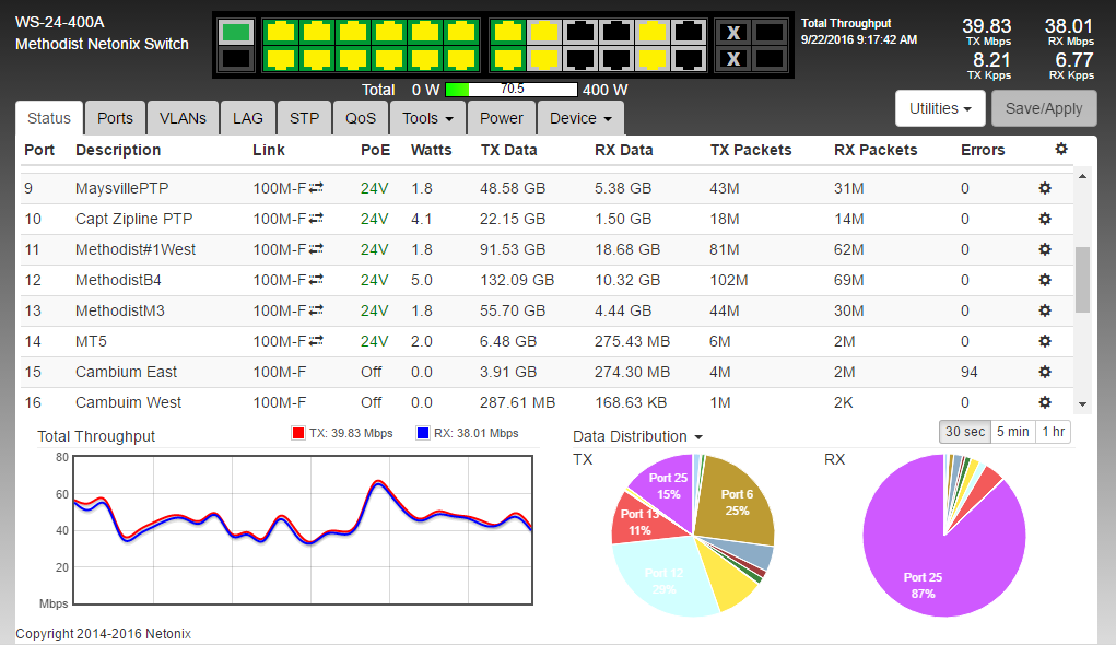

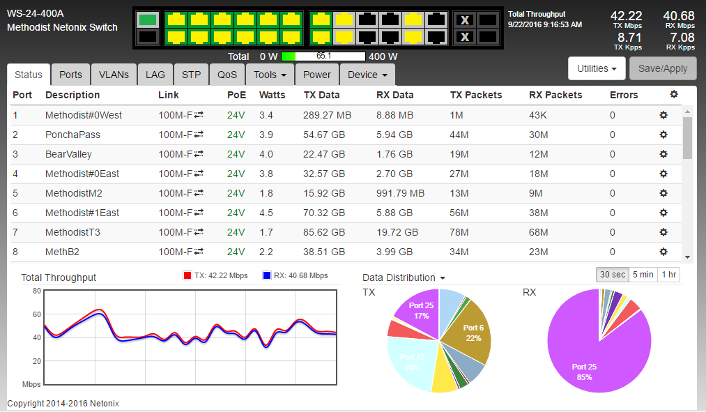

I do not see any damaged current sensors (thanks for thinking ahead and showing all ports on the Status Tab).
So I do not "think" this switch is damaged.
So there are (2) 24V power supplies on the WS-24, one for ports 1-12 and one for ports 13-24. Each are capable of a constant 6A (144 watts) constant and 10A peak (240 watts).
The total watts being used on ports 1-12 is less than 60 watts constant so your demand is far below the capacity of the 24V power supply taking care of ports 1-12.
I do see the radios rebooting in the log which is odd.
So I have some questions:
1) As asked above are the tower ground rods bonded to the electrical service ground rods with a heavy #2 wire?
2) How long has this switch been in service?
3) Did this behavior just recently start or has it been going on for awhile?

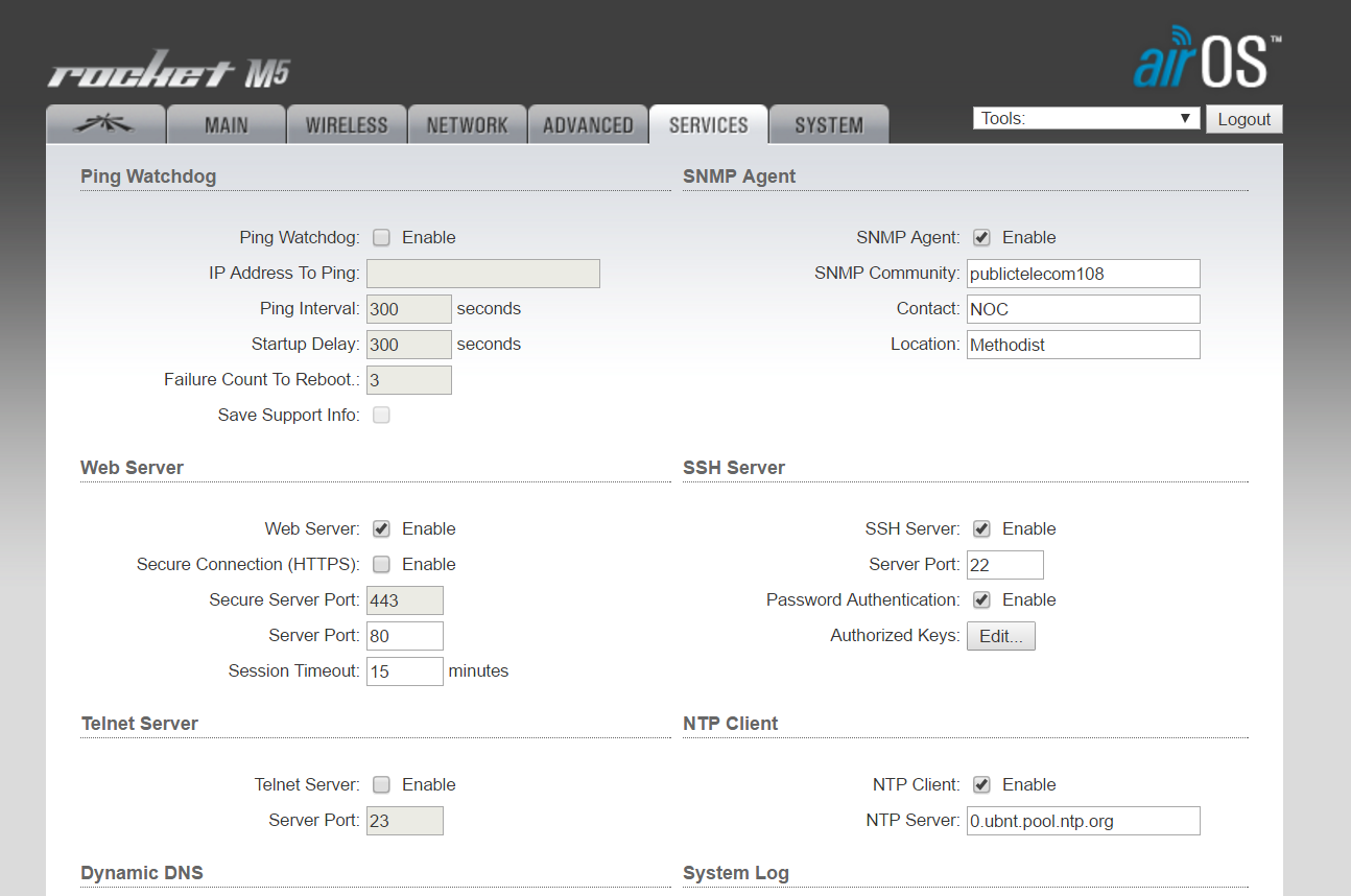

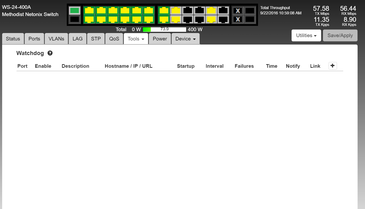

4) Are there any watch dog rules defined under the Tools/Watchdog Tab?
5) Can you please verify if the UBNT Rockets have a ping watchdog enabled.
6) And you do log into the Rockets and verified that indeed they are rebooting by looking at their up time?
7) The switch is not rebooting at all?

1) The UPS is grounded with a #4 solid wire, but I'm pretty sure that is sufficient, not sure a #2 would even fit in the lug. The AC must be grounded to the earth, this is a large tower site with many other providers on it. We are on our own circuit breakers, and share the service but I will verify next time I'm on site. Let's assume it all good.
2) The switch was just put in service.
3) This problem started occurring right away.
4) There are no watchdog rules set in the switch.
5) There is no watchdog rule set in the AP's.
6) The Rockets are indeed rebooting.
7) I only rebooted the switch due to the firmware upgrade; the switch seems to stay stable during the whole incident.
I'm wondering if one devices wiring could cause another device to short out is there some kind of isolation between the ports? I'd be willing to believe that one device has bad wire ends or something but not all of them.

kevinpez wrote:1) The UPS is grounded with a #4 solid wire, but I'm pretty sure that is sufficient, not sure a #2 would even fit in the lug. The AC must be grounded to the earth, this is a large tower site with many other providers on it. We are on our own circuit breakers, and share the service but I will verify next time I'm on site. Let's assume it all good.
I was not saying a #2 ground wire to the UPS I was asking is the Electrical service ground rods are bonded to the tower ground rods with #2 wire or heavier.
If not then your Ethernet cables become this bond and ground potential current starts flowing across your Ethernet cables.
Here are some good posts on grounding to better explain this concept and potenital problem:
viewtopic.php?f=30&t=1816
viewtopic.php?f=30&t=188
viewtopic.php?f=30&t=1429
THESE LINKS ABOVE ARE REALLY GOOD READS
If your ground rods are not bonded (Electric Service Ground Rods connected to Tower Ground Rods) then you will soon start frying things in this order:
1) Current Sensors in the switch
2) Either the Ethernet port in the switch or the radios or both.
Now could this cause radios to reboot, well if it is enough ground current yes but more likely it will just start frying stuff.

If a wire is shorting "momentarily" and I mean just for a second it might cause a dip in the 24V power supply....."MAYBE".
You could test this theory by moving some to the higher ports as they are on a differnt 24 power supply. Then if ports 1-12 reboot you know it is one of them and if it is ports 13-24 you know it is one of them.
