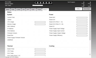

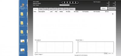

I've got one switch that is not displaying any status data on the web gui. (see attachments)
Not sure what is the problem. Running latest firmware.

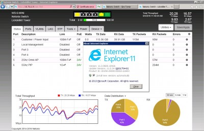

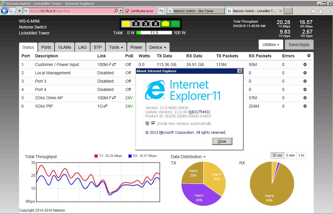

I should also mention, I don't suspect it to be a browser issue, because this same browser works just fine on a different netonix switch (which just happens to be the same model and running the same firmware).

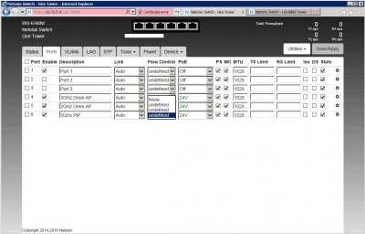

Also, notice the flow-control options...

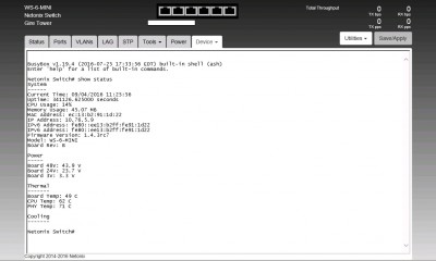

Re: no status data shown on web gui
Sun Sep 04, 2016 10:14 pm
is this switch live in service?
Can you SSH into the switch then drop to Linux command line by entering in the command "CMD" then press enter and do TOP and put up the screen shot
